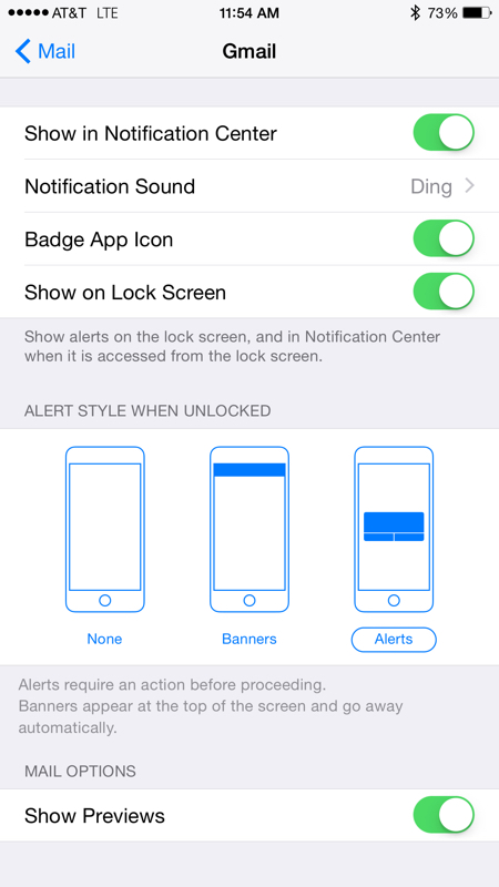

See if this helps ... Mine didn't wok till today when I clicked "Show on lock screen"

Old Mar 18, 2015 | 10:17 AM
SpartanVet's Avatar
SpartanVet
Joined: Jul 2012
Posts: 137
From: Newton, NJ
Great thank you, I'll try that and report back after my drive home!

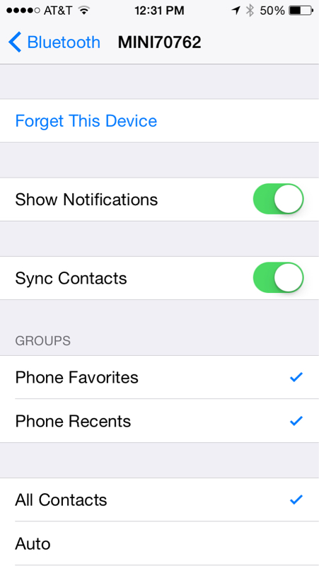

To get messages to work with my iPhone I had to go into the bluetooth settings in the phone, select the car and make sure "show notifications" is checked. See photo.
