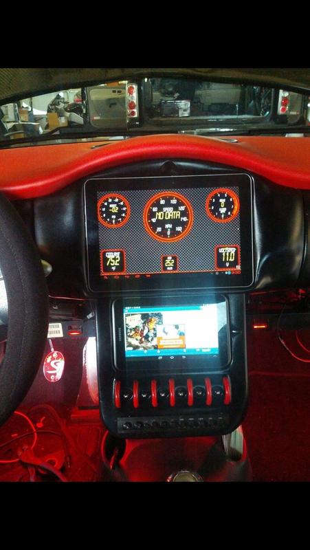

I know this is 2nd gen, but, here's a tablet install...
