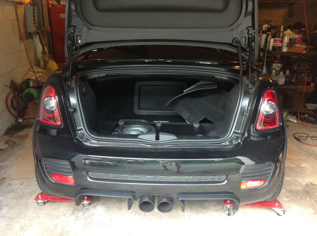

Yes - the floor is "raised". The sub is underneath.
False floor in place.
What's hiding underneath...

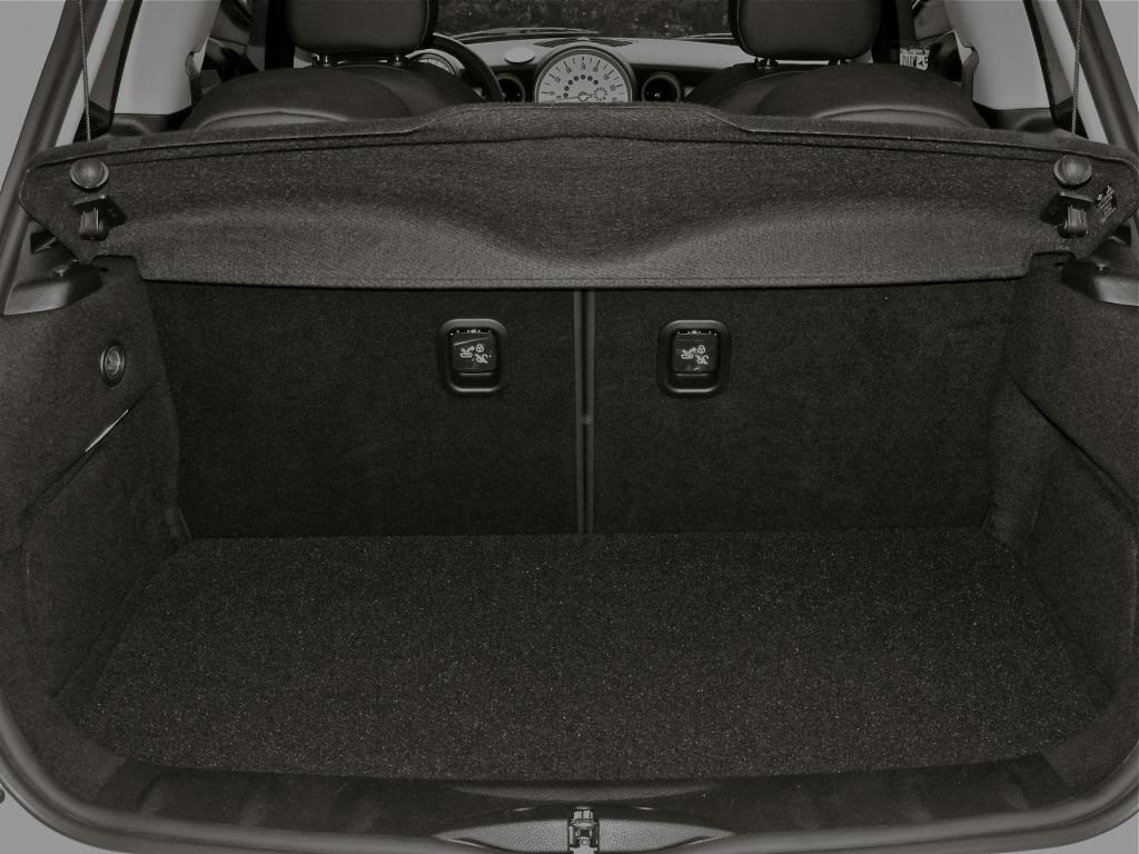

I have it installed in a R59.
