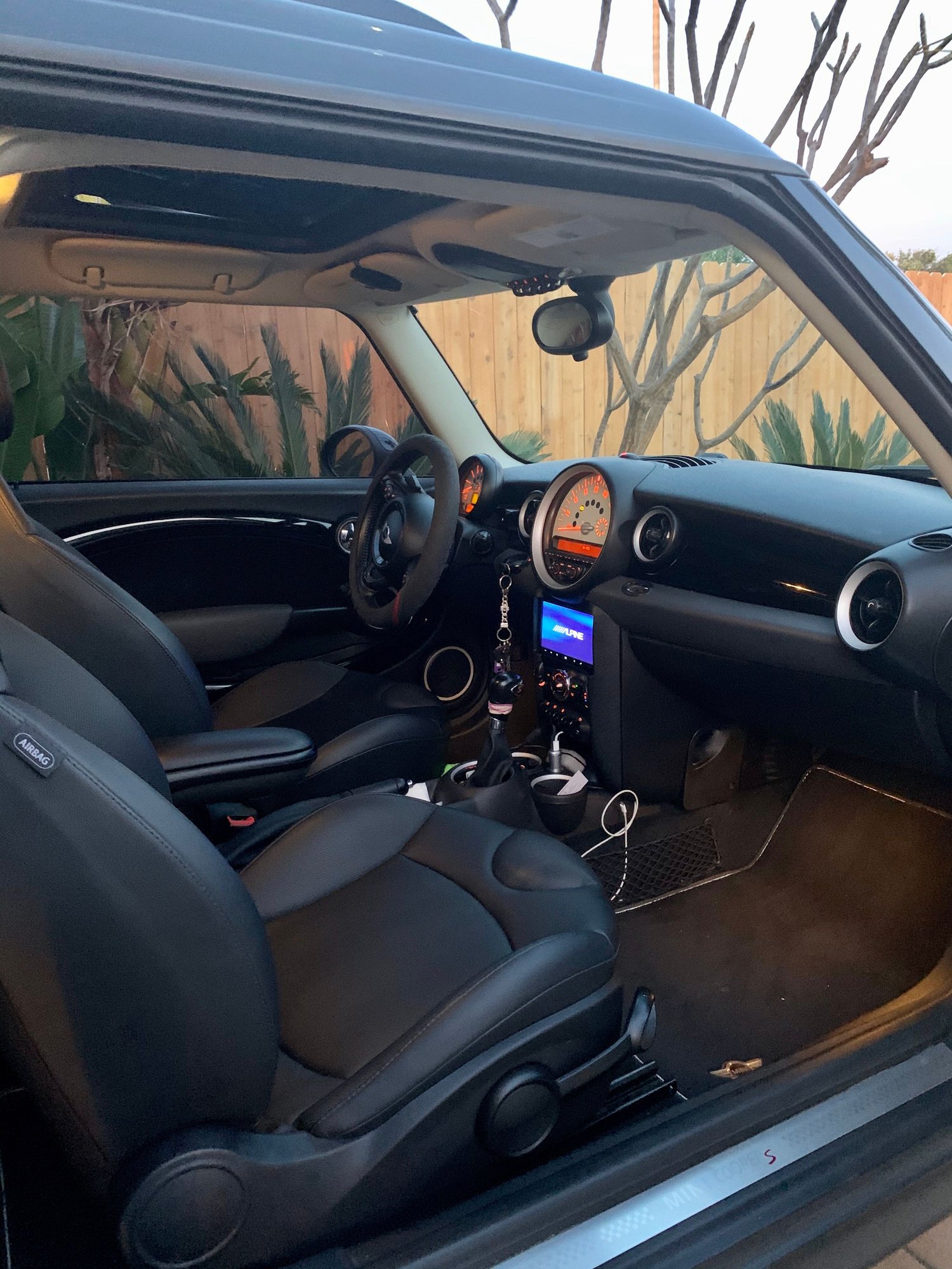

I would love to know how ptidwell wired that double radio in... I'm looking to order one of those HK enabler plugs just trying to get a little clarity
before I pull the trigger from the supplier...
