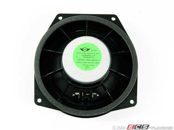

Here is the rear bottom door speaker on the base system of the R50 r52 r53. And Rear base system speaker on the R52.
Looks like 4 Ohm
Looks like 4 Ohm
