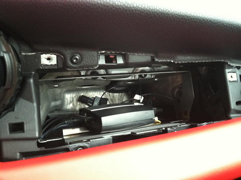

So I have completed the install of my Audiovox Dice Universal RDS USB http://audiovox.diceelectronics.com/fmrds-usb-pro-avx
All in all I'm pleased with the result since I have Sirius again and the sound is great. The device actually shuts down FM reception while in Sirius mode so as to allow for less interference I assume. The only problem is if I want to go to another FM station I need to change the source of the Dice to something besides Sirius before I change stations.
Here are some mid install photos at key points.
https://picasaweb.google.com/1081095...84506096001138
I hid the Dice device behind the smaller glove box because the power cords for it had to go to the fuse box at the passengers feet. It just fit.
https://picasaweb.google.com/lh/phot...eat=directlink
I hid the Sirius SC-C1 in the crawl space below the factory CD player where I was also able to store the extra cable slack. Since I was using the factory Sirius antenna I then had to run that cable down the center console which worked out quite well, but not without some work trying to get the cable to plug into the factory antenna under the passenger seat.
I had to use 2 add-a-circuits. One for constant and one for switched power. I used #13 and #21, I forget which is which.
Here is the before picture of the FM antenna adapters with the green clips. The one on the bottom ended up being too long because there wasn't enough space behind the factory radio. I ended up ripping it apart and wrapping it with electrical tape to the radio would fit again. What I really needed was an end with a quick right turn instead of straight out for a couple inches.

Finished the install of the Audiovox Dice Universal RDS USB.
The remote sort of sucks and it's the only way you can flip channels but I'm glad to have Sirius again.

Attached photo of where the Dice device is sitting behind the upper smaller glove box and the 2 add-a-circuits in the passenger side fuse box.
Attached Thumbnails Looking at 2009 JCW - How to best add Sirius?-img_0869.jpg   Looking at 2009 JCW - How to best add Sirius?-img_0862.jpg
