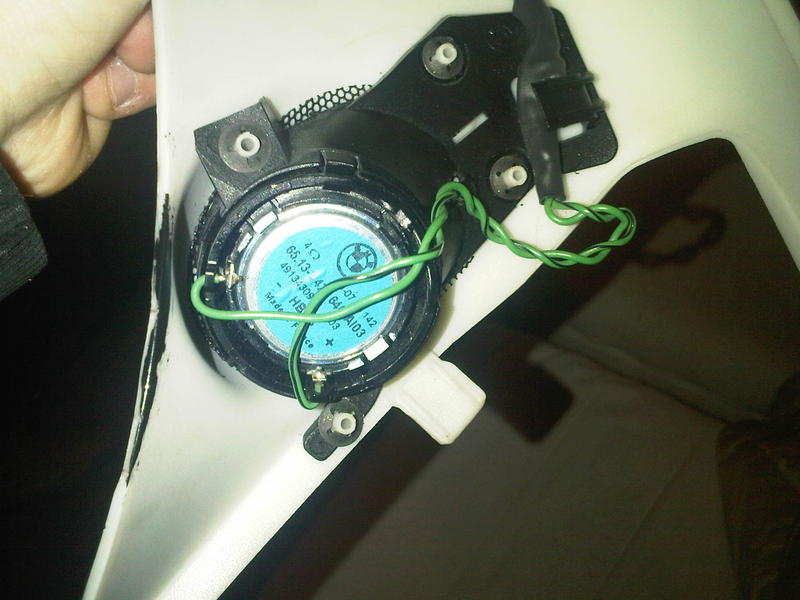

Old Jan 24, 2013 | 02:22 AM
cjm's Avatar
cjm
Joined: May 2012
Posts: 174
From: West Sussex, UK
Update:- Thanks to an ikbendennis recent post this pic shows how the OEM 4ohm tweeters push/snap-fit into the a pillar trims. Clarions and HKs should be the same physical fitting. One of the securing tabs is very easy to see at ~12 o'clock.
Attached Thumbnails Aftermarket tweeters in HK a Pillars, what brands / sizes fit ? MCS 2012-oem-4ohm-tweeter.jpg
Old Jan 24, 2013 | 06:26 AM
Kevin@Integral Audio's Avatar
Joined: Oct 2010
Posts: 464
Likes: 29
The OEM tweeters will fit into the OEM mounts - that shouldn't be surprising to anyone. It's a proprietary mount, aftermarket tweeters do NOT have this same housing. You could get lucky with a tweeter that happens to have the correct housing OD and a surface mount lip at the correct depth, but no aftermarket tweeter is designed to mount this way. Regardless, mounting tweeters that don't snap-fit isn't that difficult, and fitment/mounting is the very least of the issues. The details of why this is a bad idea have been hashed out ad nauseum on this forum.
