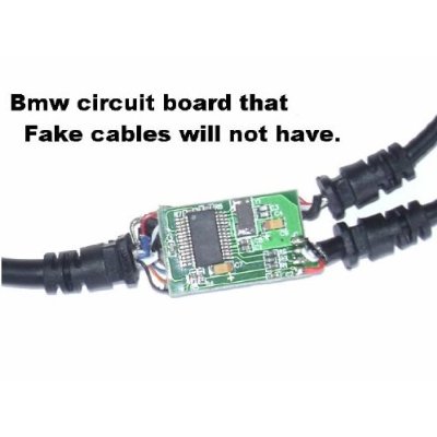

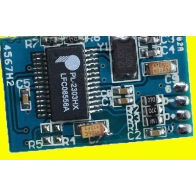

It works! But, I used the genuine the genuine Apple Adapter Lightning to 30-pin Adapter with Cord--you may also use Apple Lightning to 30-pin Adapter (both have internal electronic parts) AND a functioning genuine MINI Y-Patch (it too has internal electronics) that came with the car.
The service department and I found one genuine MINI Y-Patch Cord to be defective. We switched it out for another and it worked fine.
So, before you give up in frustration make sure you have the genuine Apple Adapter and that the MINI Y-Patch Cord is not defective. Photos of internals shown below
Attached Thumbnails iPhone 5 and Mini Connect-y-patch-internal-0440796.jpg   iPhone 5 and Mini Connect-ypatch-internal.jpg   iPhone 5 and Mini Connect-apple-adapter.jpg
