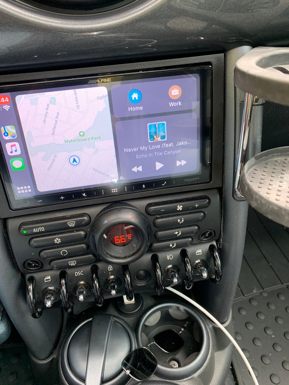

This is what I have done with my sat nav car

its a long shot since the thread is dead. But how did you get this to work? Im looking for a double din inside a nav unit aswell...

So I to was interested to see how this would work. So I purchase an Alpine Double Din unit. I had a spare surround that I could play with from a dead GPS unit. What I wanted to try and do was to get the unit in there without having to rewire things.
What I found was I could remove enough material from the white and black plastic areas to get the HU in with the circuit boards removed.
The issue came when I went to drop the boards back in. The top one fit ok but the lower board got caught up on the plugs that join the lower and upper boards.
This can be resolved if you want to relocate the lower board and extent the cables. This would mean that you are no longer able to see your fuel gauge though so you would need an alternative means to display this.
