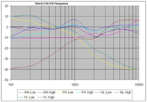

#1 is caused by different speaker mappings between MINI and E46.
Before we start, let me explain a bit of E46's speaker mapping as there could be multiple way to finish this section.
E46 HK amp is essentially 8 channel power amplifier but has "10" channel output on connector. How do they to that? They simply drive front mid range speaker AND front tweeter with same amplifier.
From the pin mapping table, followings are connected together.
Pin 42 (MFR+) == Pin 11 (TFR+)
Pin 41 (MFR-) == Pin 12 (TFR-)
Pin 40 (MFL+) == Pin 33 (TFL+)
Pin 39 (MFL-) == Pin 34 (TFL-)
Since I decided to use both Front(F)/Rear(R) woofer output to Woofer A/B respectively, I swapped pin 22 and 23 with pin 1 and 2.
Pin 1 and 2 <--> Pin 22 and 23
As MINI's door speaker is full-range speaker, I decided to exploit that the fact above that one amp has Mid and Tweeter signal. So, I moved
Pin 33 and 34 (DFL) --> Pin 39 and 40 (MFL)
Pin 31 and 32 (DFR) --> Pin 41 and 42 (MFR)
Now, for tweeter, it's straight forward as there are only two unused power amp outputs.
Pin 11 and 12 (TFL) --> Pin 31 and 32 (TRL)
Because my F == R, it's fine.

After this modification, I can hear that the T/M/B balance is different from old HK audio and Bass/Treble control doesn't help much. Mid-range seems a bit weak. It could be just my perception so somebody may be ok. This speaker re-arrangement could be done differently with different sound outcome.
If you have better idea, let me know.

I made a fixture and took some data on the E46 HK amp. The two types of channels provided by the E46 HK amp (front and rear) have different crossover points:
These are relative gain values with a fixed input level:
Rear
Rear
- Low frequency output - approximately flat, 0dB gain.
- High frequency output - high pass @~2.9 kHz, +6dB gain @ 10kHz.
- Low frequency output - low pass @~400 Hz, +8dB gain @100 Hz.
- High frequency output - high pass @~400 Hz, 0dB gain @10 kHz.

Bradly99,
This is very good data. Now I can see why there is excessive treble ( my tweeter is connected to rear HF output which has 6dB gain) and weak bass (mismatched and unbalanced front/rear LF output ).
I don't have good idea come up how to resolve this though.
