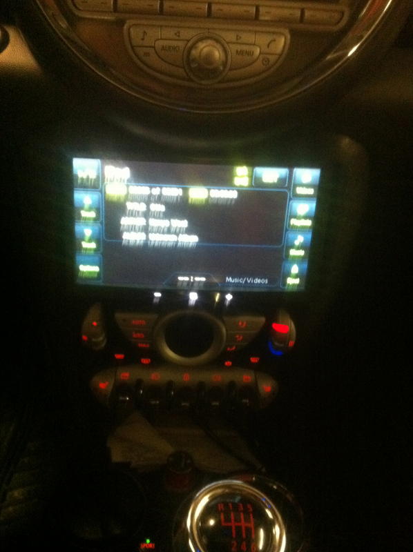

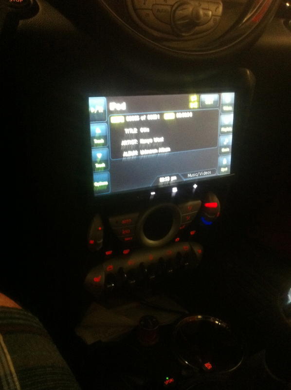

Double din
[QUOTE=GTECKO;3477092]Yes I have read it and please enlighten me with where you have got your information from as I have tried and look on how to "switch it off" and came up empty ?
Anyway, I am glad to say that I am done with this install ... Went back to the shop and literally work with the guy on the car. His excuse was that when he was looking for a power cable, since my lights were on and he tested the source for the wires,he basically connected it to the lighting cables ...
So we took the dash apart (again round 2) and I must that that it can be done within 15 to 20 min.
The hardest part for me was the screws in the vent over the speedometer...what a pain,especially to put them back in afterwards.
Best DIY video were found on youtube, his Mini was destroyed so he did two video on how to take the dash apart.
and
Very interesting to actually watch,rather than pictures or a written step by step.
As I mentioned earlier, I ordered the 32pin cable and it was wrong ...
So anyone who has a 09 MCS, don't get it ... you need to 40pin (ordered from buddy in Thailand, he made me pay shipping only since I had purchased the wrong one) I can sell the 32pin if anyone want.
So when I receive this, round 3 ,maybe, I ll put it back in for the LCD to show up.
As far as the dealer told me, the only thing you will miss, is the LCD and its interaction, it will not make your car go angry
as someone mentioned in the beginning of this thread. (Now this is what the dealer told ME for MY car, I can't vouch for any other year or model)
For the steering wheel control adaptor
if you bought the same one as I did, be careful...the manuel is wrong. I had to call them to found out they only update their paper manuel every 4 years. Anyway, you must use for a MCS the Pin#11 to the car that would go to PIN cable 1 to the ASWC, and PIN 9 to the car,going to Pin 7 cable to the ASWC,nothing else, no PIN 8 or brown cable as mentioned in the stupid manuel.
Of course, plug your power and ground. To be honest, less than a minute to make it worked. So happy I have this on.
Wired the camera, however I bought the wrong one from Ebay and made a mistake. Therefore Im gonna upgrade to a little more expensive one
If anyone wants it, I have the camera with a wireless module to sell
Putting everything back in was a bit of a B$*ch, too many cables, camera,iPod,aux, switches for video,double din own cables...its tough to snug everything and have the mettra go in easily. Push it in, hold and put the screws on. We removed the centre console,just unscrew it and moved it to backwards, as we tapd the power to the accessory cigaret charger,and it made it much easier to manoeuvre with the Metra kit.
I used electrical tape on every cable connector at the back. First time we put it in, lost the yellow video connector for the iPod...seems like when we pushed the deck in, it got disconnected.
I can't tell ppl what wires go where, as every aftermarket unit is different. However my manuel was pretty clear. I paid someone to help me do the wiring as I didn't know what to do really, I just wanted the wiring to be done correctly more than anything else, if you know electrical a bit, you are good to go.
I will probably take apart the dash as the part where the glove compartment opening button is, is not put on totally straight.
If you know anything about wiring to power and what cable goes where,this install is actually not bad, looks depressing when the car is apart though
I have two bad pictures, I ll get some in the daylight tomorrow.
Big thanks on everyone who contributed whether trough PM or on this thread.
