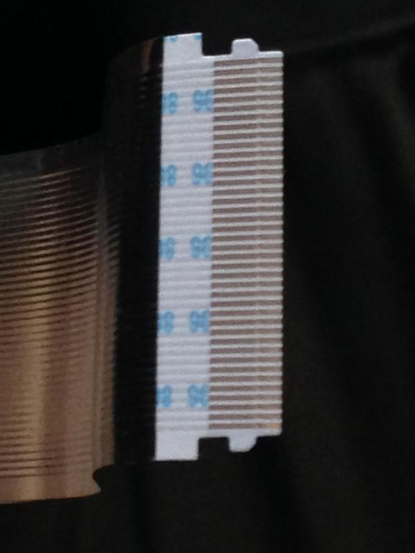

Question for you guys that have done the cable extension. I've attached a picture of the cable off the guy on Ebay from Taiwan. His cable is on the top. The 40 pin OEM cable is shown on the bottom from the unit out of my car. The pins are exactly the same but the overall cable width of the OEM cable is slightly wider. Thus the replacement cable doesn't sit in the harness without some side to side discrepancies. Therefore the pin placement with the new cable could be off.
So what did your cable look like ????

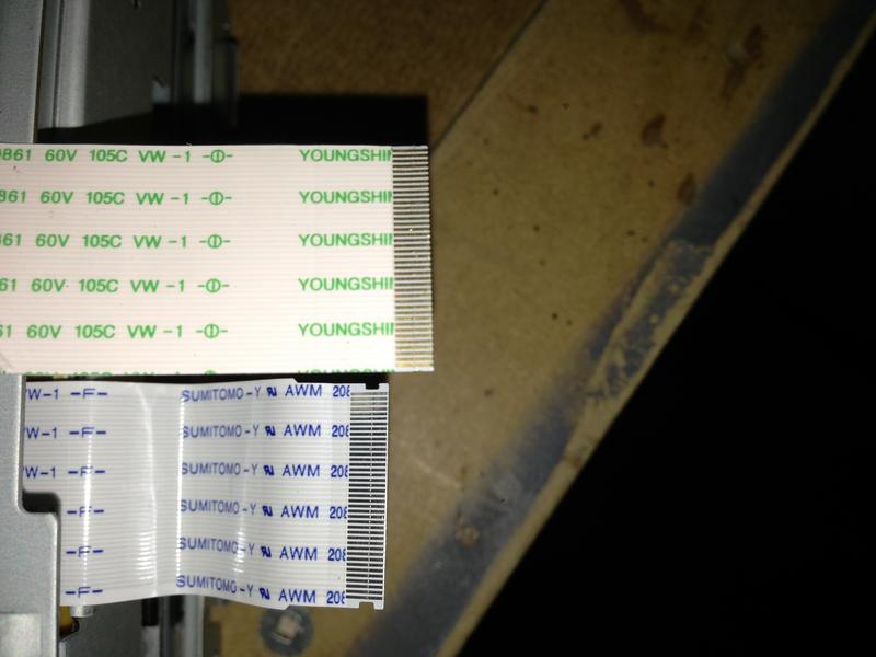

Anybody have any idea what this cable is? It goes from the LED board to the board between the volume and the CD player itself.
I just bought a cable and I am almost 100% sure it's the wrong one.
Any help?
Attached Thumbnails 2007 Double Din Install-img_0466.jpg   2007 Double Din Install-img_0060.jpg
wrong cable from the car. there are 2 ribbon cables: one that links the volume **** circuit board with the control **** module (with the display that fits in the speedo), this cable is NOT what you are looking to replace and it looks like a chrome/aluminum foil like.
the one you are looking for is where the volume **** circuit board links up to the cd player, the actual headunit where the cd slides in. this cable is originally very short, running at about 2-3 inches tops. the wider, chrome-like ribbon cable is about 6-8 inches.
replace the intended 2-3 inch ribbon cable with the extended one you've purchased by popping the lock from the circuit board, pulling out the ribbon and replacing it with the new one, reverse procedure. note: to get to the other end where it is linked to the cd player, you must semi-dismantle the CD player to reach the ribbon cable. three philips screws and you should be able to pop out two of the guard panels on the player and access the ribbon port.
my trouble is fitting the darn unit up the back of the speedo. OP couldn't have simply slid it in. there simply isn't enough room unless if some cutting of plastic is carried out.
trust me, i've tried stuffing it above where the unit is situated in the picture.
