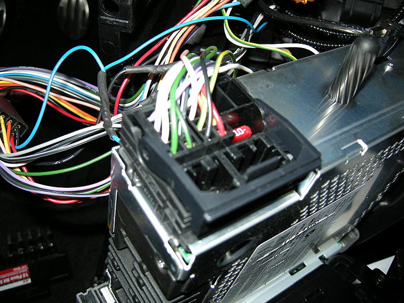

and what went into the loom. I finally got it all sorted and my Aux. input back by the third try. The black twin cables are fiber-optics required by the radio and the cd changer

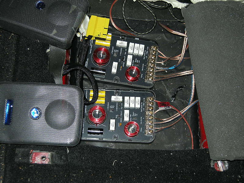

Then I put the Upstage Blending Modules under the drivers seat. They were large. The wiring sequence is power amp out to Blending module, circut to the tweeters in the A-pillars, and power on out to the 3 way crossovers.
The Kenwood 4 channel amp went under the passenger seat. 12 ga wiring from the amp to the Blending modules, and 12 ga on out to the 3 ways 16 ga to the Apillar tweeters. The 12 ga to the doors went through to boot between the door and the frame. It.s tight, but it fits nicely in the notch at the bottom of the frame connector. This is the link to a great "how to" from Schatzy62. https://www.northamericanmotoring.co...155-post4.html Thank you sir!! I wired from the door to the cabin, fishing it through with a piece of coat hanger, pulling the boot loose from both ends, running the wire to the cabin, then back through the door and the rubber cap that the mid-woofer wire goes through, and on into the armrest. Tedious, but do-able. Makes for a clean install.

and it comes with its on little set of quirks. I ordered the kit from Outmotoring, and when I got it, it was clear that they fully intended the dealer install it. Once again, I followed instructions found on this forum, and managed to get the secret compartment out of the dash, and locate the WIRING referred to by everyone, but no one mentioned the fiber optic cables, and how they had to be separated out and plugged into the wire socket. So, I plugged the wiring into the socket and put the dash back together, but now the secret door won't shut....and the Mini doesn't see my Ipod. Pulled the dash apart again, out comes the secret compartment and in all the excitement, I got the silver lever out of place
Line it back up, and the secret door closes just fine. Then, I notice a bundle of fiber optic cable back in the back of the compartment space, and it triggers a flashback of the headunit loom, so I fish it out and take off the blanking plug which looks nothing like the illustration in the instructions. The link to all of this is at
https://www.northamericanmotoring.co...t-removal.html
Looking at the back of the plug going into the interface, it is obvious that the fiberoptic cable is required for the unit to operate. Snap it in place, button up the dash, and off to the Mini dealer for a service, and programing to recognize the Ipod....except it won't recognize MY Ipod Classic. It's a Gen.5, so It ought to work. get home, and plug the wifes Ipod in....it works. Now, does anyone have an idea about why it won't recognize my Classic?(running the latest version of Itunes)
