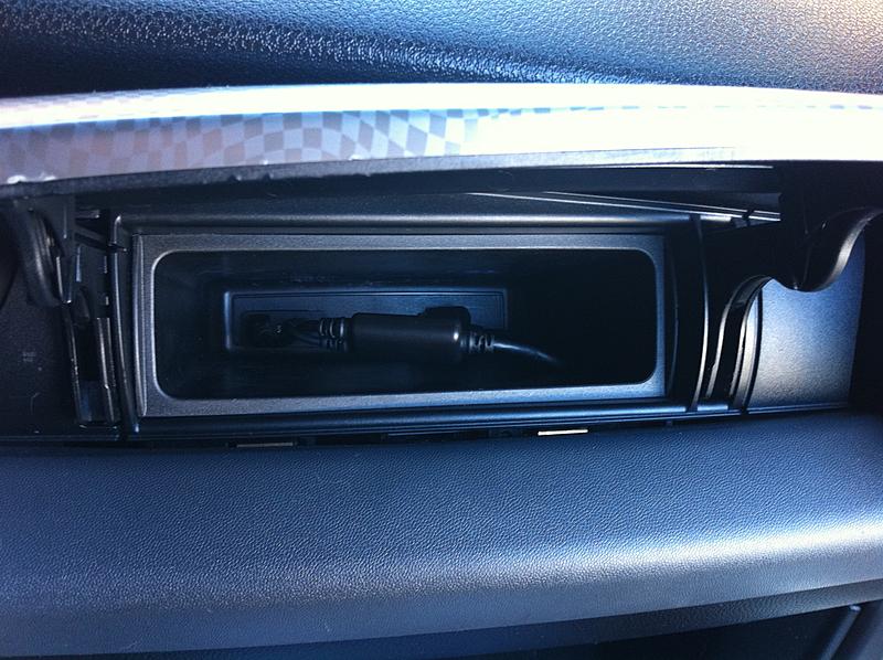

I too was dissatisfied with the location of the AUX/iPod port in the car. I realize that most automakers will put these ports close to the radio for simplicity's sake, but personally I didn't like the idea of cluttering up my center console with cables and an iPod I will never need to touch, let alone leaving my $250 investment sitting there for everyone to see when I leave the car.
Hence:
However, I must note that there are pros and cons to doing this:
The Good:
1. When the secret compartment is closed, you can stash a 60/120/whatever GB iPod in there and never need to fuss with it until you need to add/remove music. Everything works through the stereo and you get a nice clean look. I've had people ask me "Where is your music coming from?" after they look around the cabin/glove box and can't find my iPod.
2. Security. Your interior looks all but empty with this setup. No one can tell you have an iPod/iPhone/whatever in the car.
The Bad:
1. Relocating this cable was HARD. I mean effing hard! I had cuts and scrapes all over my hands, the cable was barely long enough to reach from its stock location to the glove box, and required me to take apart almost the entire dash (all the way over to the driver's side air vent) to remove the parts necessary to re-route the wire.
2. Once you do this, it will be difficult if not impossible to undo it. The plastic module with the USB and mini ports on it (pictured above) is secured in such a way that you cannot remove the secret compartment enclosure once this is set up without damaging the module or the connector on the wire. Plugging everything in the first time required needle nose pliers.
3. Connecting/disconnecting the Y-adapter is tedious. Luckily, you will rarely if ever have to do this. In 2 years, I think I have unplugged that cable twice. If you use an Apple device on the regular, you'll only ever need to interact with the 30-pin side of the Y-cable, so it doesn't matter much.
Attached Thumbnails Most ridiculous location for aux and relocating-ipod-secret-compartment.jpg

OUCH. that was something along the lines of what I was thinking. Hmmm... may have to do a half-*** version. Am thinking I can run a 30 pin extension from the Y cable, and run the extension up the dash into the secret box. That may make life a little easier and then I can recess the aux in side of the equation.
Thanks for sharing!

That is an absolutely beautiful install. I'm going to attempt a similar install, however via extension cable rather than relocation of existing ports.
