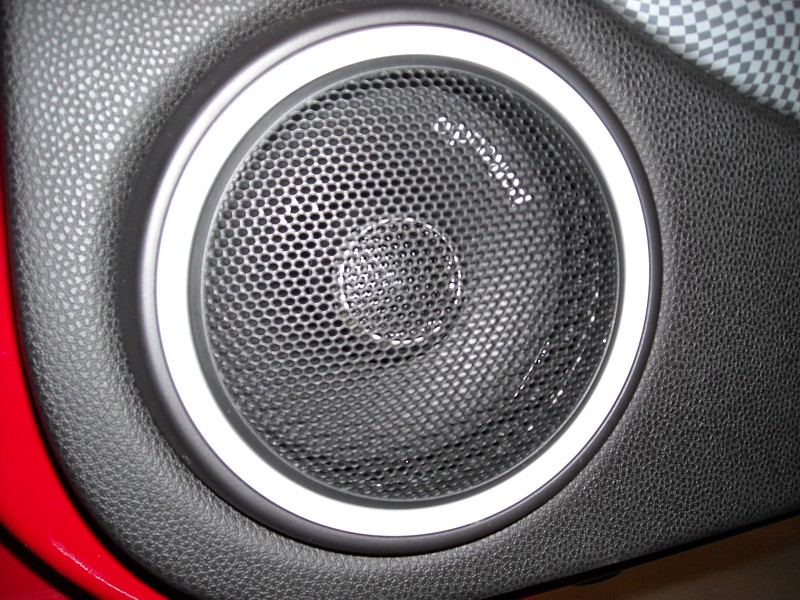

FWIW, I installed Polk DXi 650s and 350s in my 2010, same mounting as these DB 651s and 351s. My 3 1/2" 350s went in just fine. Used an OEM screw location to mount the first tab (upper most location), then when I had the speaker located just where I wanted it (centered with the speaker housing), a small drill bit into the mounting flange lip and threaded in a second OEM screw. As a heads up, if you mount the speaker dead center in the mounting hole, the cone will not be aesthetically centered in the speaker grill. Don't asked me why, something with the speaker housing itself. To be centered in the speaker grill, the speaker itself will be just north of dead center.
Here's pictures of my 3 1/2" DXi 350s and DXi 650s mounted.
Attached Thumbnails Just bought new speakers, will they fit?-dscn0017.jpg   Just bought new speakers, will they fit?-dscn0014.jpg

I saw your post about doing the Dxi350s & dxi650s in the million post replacement-how-to thread. I was wondering if those were the slim versions you used, since only the 6.5" seems to come in a slim. ie, was that the Dxi650s or Dxi650's that you used.

either one will fit fine fyi

DXi650, about 3" deep...so kinda shallow.
