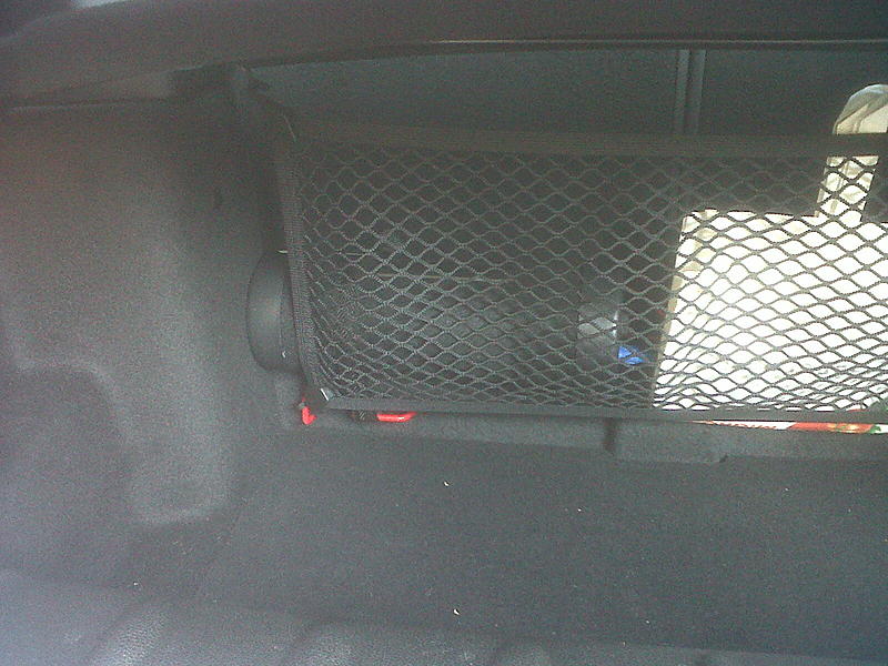

here is a pic of my little mini sub tube. still have full use of my boot space too
