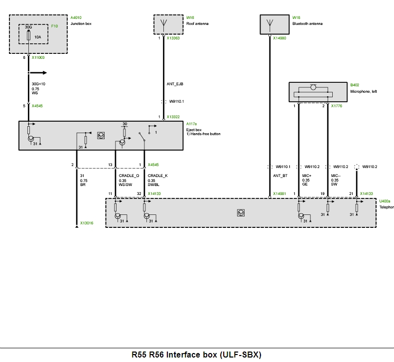

Anywhooozle, I think you guys are mis-interpreting the read in the manual. It's not saying that it is a "wireless connection between the phone and the external antenna". It is saying that when you connect the phone to the snap in adapter, you are connecting directly (via hardwire) to an external cellular (aka wireless) antenna.
It's not written the best in the 1st place (in German), and then it's being made worse thru a bad translation to english. That's my take anyway.
I do know for sure that there is an antenna lead in the armrest, that goes down into the car and into a black box. I've seen that wireing diagram. If I recall (and I'll look for that diagram again..link to it somwhwere...), the antenna is the body of the car.

This should help.... see attachment

I don't know what it means. I see the box on the bottom with wiring for cradle, hf button, mike, antenna. The antenna line does not go inside the box. What do you make of this Birdman? I don't see why wiring needs to go to the mike with BT on either.

I thought in one of the bluetooth threads on here there was talk about a phone cradles which used multiple connection points on the phone cradle to the phone. Using one for power and one for antenna. I would guess if that is the case, the phone cradle itself would have that wiring connection. I don't think that wiring diagram has the cradle wiring shown.
