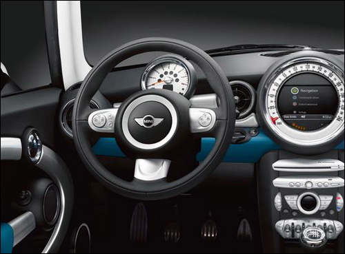

Here's a picture of the two-gauge setup on the steering column that you were probably thinking of. It's what you get when you order the Chrono Pack or factory navigation.

thanks for the replys guys.
isnt that the fuel level under the oem nav in the picture?
pretty i just want to know if i got a 1st gen mini (the 2nd picture) could i replace the center gauges (the big ring) with the Oem navi (big ring) and throw a aftermarket in that double din? wouldnt the fuel, temp etc harness right up and the navi would be a seperate harness set up?
The second picture shows a first-gen car with the Chrono pack - that's an option that most of the cars don't have.
And what "double-din" are you talking about? The center of the dash (where the big speedometer, factory nav, or Chrono Pack goes) isn't big enough for a single-DIN device, much less a double-DIN one.
That is the fuel-level gauge under the OEM nav in the first picture, but I don't think you can order just the large ring and the fuel gauge from the nav kit without getting the entire nav screen assembly.
Thanks Scott you answered my question. I have a x5 and the oem nav can be replaced with a double din. I thought the mini nav looked different but youre right, its not even wide enough for a single din. Thanks again Scott. You Rock
