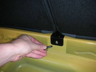

Old Aug 1, 2007 | 07:35 PM
DyeLooper's Avatar
DyeLooper
Joined: Jan 2007
Posts: 311
From: MD/DE Line
In this pic, if you go to the center of the seats and lay them down, there are tabs to the r/L of main screw, pry them left or right(cant remember) and follow my instructions from there.
Old Aug 1, 2007 | 08:34 PM
Robin Casady's Avatar
Robin Casady
Posts: 7,578
From: Paradise
Originally Posted by Birdman
Actually, doesn't make sense. Where are these tabs, on the track part of the seat, on the parts that mount to the floor, or on the seta itself....? Can I ask you to snap a shot of this?
The tabs are between the two rear seatbacks. Go straight down with a screw driver. There are two bent tongues of of black steel. One for each seatback. You have to pry one back so it frees the hub of a rod coming out of the seatback.
Then see this thread for the rest of the story.
