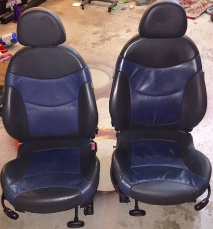

R53 Sport Seats - Front Pair - Blue and Gray
Category: Interior
Price: $150
$150 for a pair of front sport seats out of a 2003 R53. The interior color code is Leder Gravity / Lapis Blau (T6LP ).
I am sure they are NOT heated seats.
The drivers side seat belt buckle/tensioner has been removed.
I did the heated seat upgrade on my R53 and these are the non-heated seats I took out. They driver seat is in good condition. The passenger seat is in excellent condition.
Local pickup or I can arrange to meet you within the NoVa - DC - Baltimore corridor.
I will ship if you pay the shipping costs. Shipping will not be cheap. I would estimate $50 each, but I will charge you the actual cost. You would have to send payment by check or paypal before I ship and I will wait for the funds to clear.
