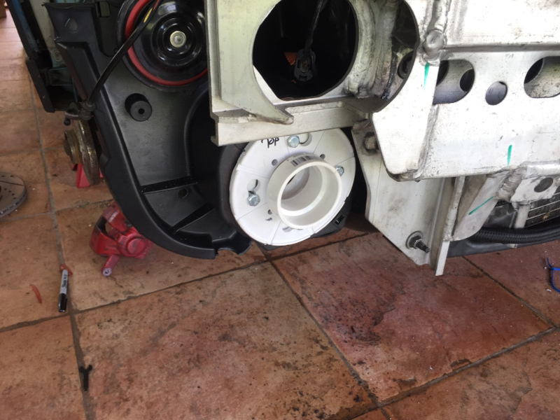

I don't know if there's a guide. But is pretty simple if you have basic skills.

Old Apr 20, 2020 | 07:09 AM
Grand-Cayman's Avatar
Grand-Cayman
Joined: Aug 2019
Posts: 211
Likes: 86
Originally Posted by bmx175
The tire will block the air flow.
Hmm. Not sure that will be significant. In fact, air has to go around the tire so there's a good chance the airflow into the duct could be higher than if the duct were in the free stream. This set-up is a lot more simple than going through the fog light holes. Plus, the air has a more direct route and less travel time through the hose. I have a Porsche GT4 and the rear brake ducts are like this.
Trying to figure out what to do on my R53. I really like that mod to the inside rotor cover to put a hose mount.

Originally Posted by Rennfahrer555
What if I just remove the fog lights trim a hole into the splash guards and call it good ?
FWIW, I did just that years ago. Used the plastic caps from detergent jugs and attached short lengths of high temp 2 inch diameter flexible tubing that go through 2 inch holes that I cut in the wheel well splash guards with a 2 inch hole saw. The tubing goes through just enough but not far enough to rub against the tires. In 14 years of HPDE events, I've never lost my brakes using the stock calipers and race pads. I bleed my brakes no further out than 2 or 3 days before an event. The trick is to use your brakes hard over the shortest distance to make the turn. I'm pretty sure there are pics here on NAM because I did a similar mod on our GP. If I can find them, I'll post a link.
Here: https://www.northamericanmotoring.co...s-made-ez.html The GP used 2-1/2 inch tubing, the S uses 2-inch tubing.
