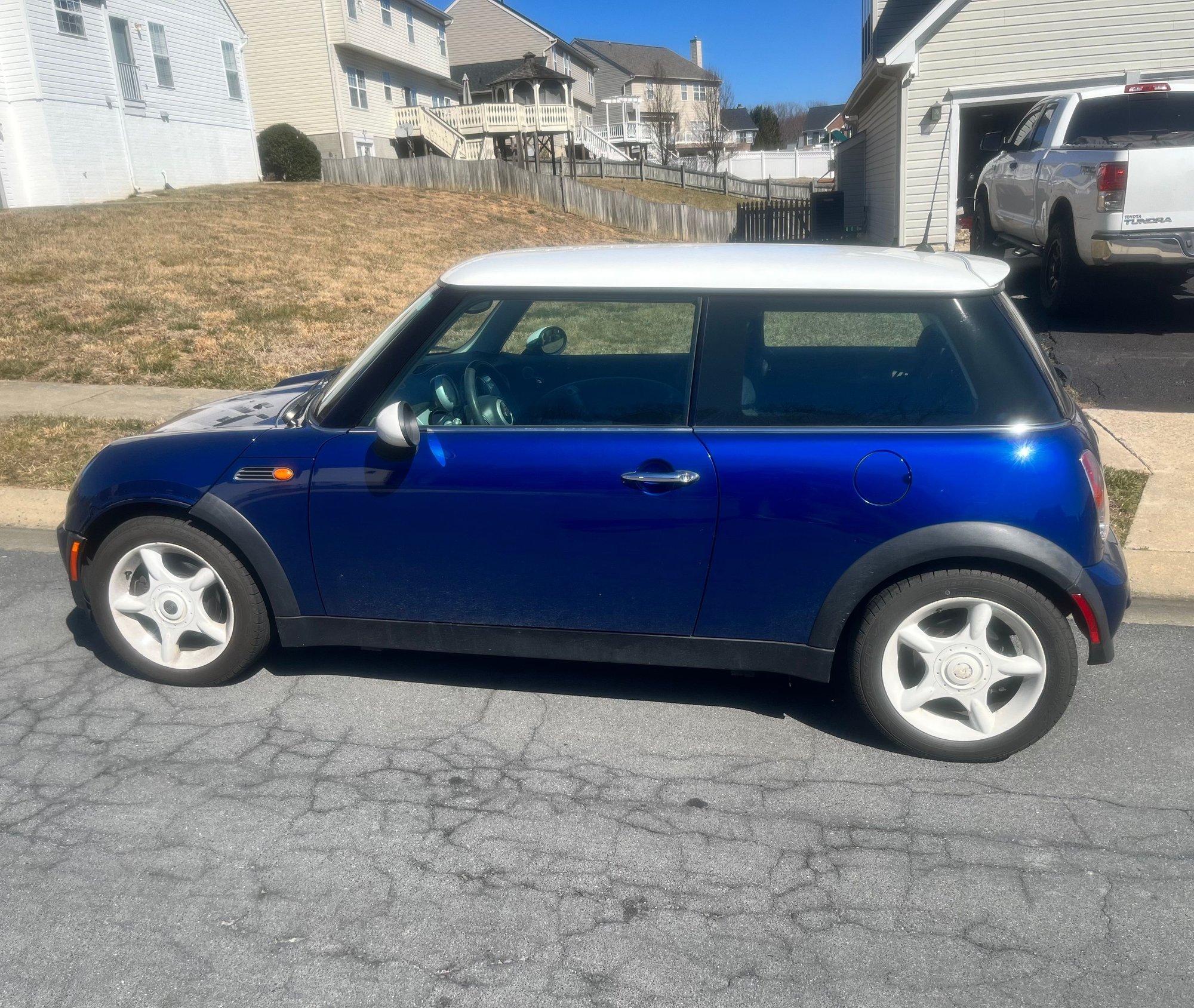

Hey everyone! New to the MINI realm as I just acquired a 02 R50 5spd that’s in beautiful condition. I have this terrible habit of not leaving anything I own stock but typically the vehicles I have worked on no long require emissions testing. Has any on the forum ever had any experience with performing and engine swap on a car the is still under emission regulations? I would love to do a K Swap and make the car an unruly little brat to terrorize the highways with but unsure how that would work as the engine and ECM would read one car while the emission system is reading another. I appreciate any insight available.
