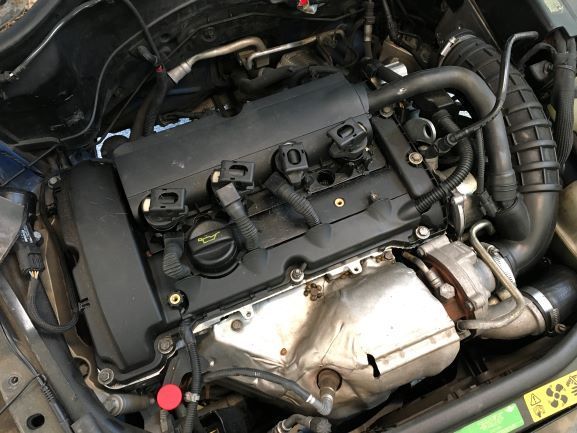

Immediately I noticed a critter had beat me to the tear down by chewing through #4 coil plug. I had used it as somewhat of a parts car while diagnosing some of the other cars, which left a nice safe opening for the rabbits during a snow storm. There was rabbit droppings all over the top of the engine as well as the chewed wire. Those wascally wabbit.
The engine had all the typical signs of an R56 with ~100K. Leaks, oil residue all over, and a few hoses worn out.

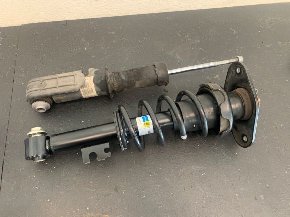

Shocks were as I've found on the other cars, very worn out. Parts cleaned, greased and a new set of Bilstein Sports did the trick.

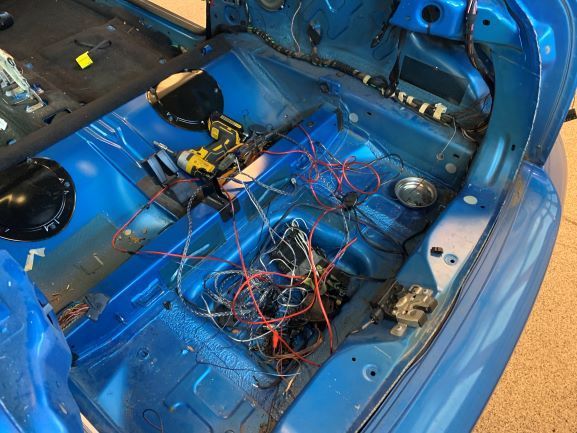

Once I had the rest of the interior removed, I could really see the level of wire repair.

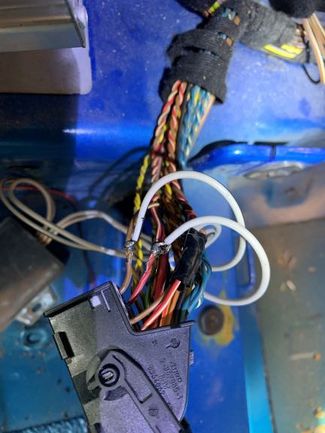

I quickly noticed a lot of cut wires with the method of wire-twisting/black tape was applied to every wire.
I can't figure out why they cut both taillight harnesses and switched all the wires. I can't imagine anything was functioning correctly.
I managed to pull out every random wire they "installed".
A little solder and shrink tubes should bring them back to proper functionality. I had to repair about 15-18 wires and connections.
