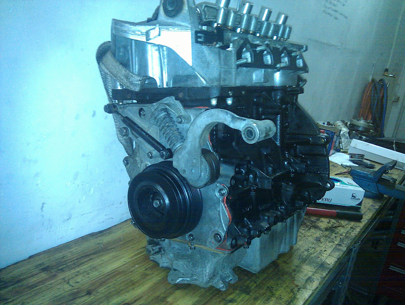

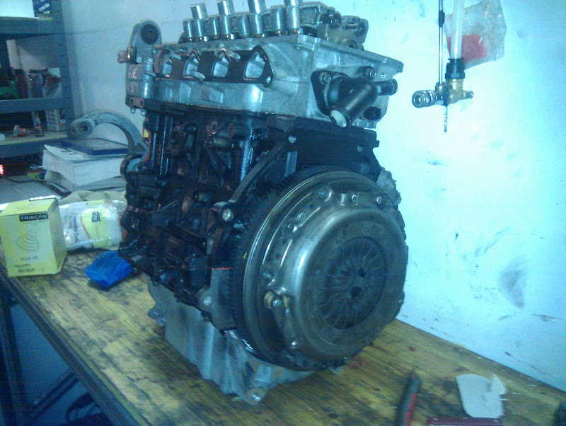

Finally after 7 months I got the engine from machine shop.
- Machined valves + valve seats
- Ported head
- Machined and balanced crankshaft
- Ported engine block
- New piston rings
- New main bearings and rod bearings
- New gasket kit, top end and bottom end

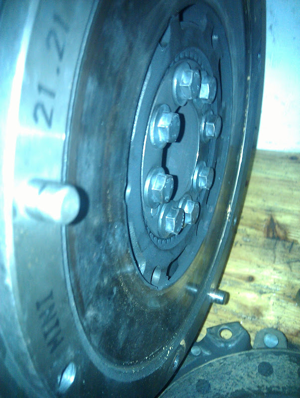

Checked on the clutch, it was over also, so I ordered a new one
Installed the valve cover, intake manifold and some misc parts

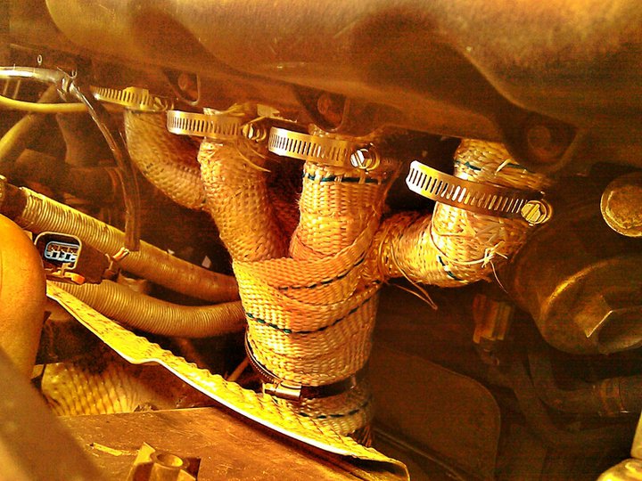

Heat wrapped headers

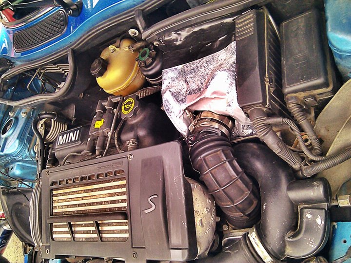

Custom made air filter box with heat protected sheat!

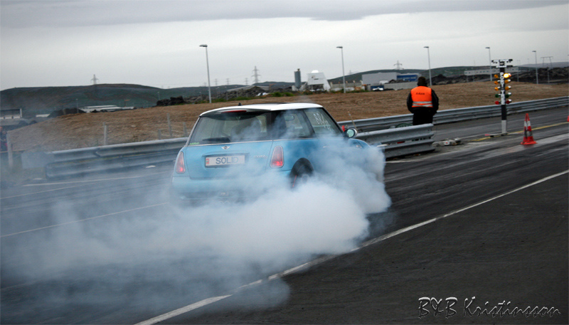

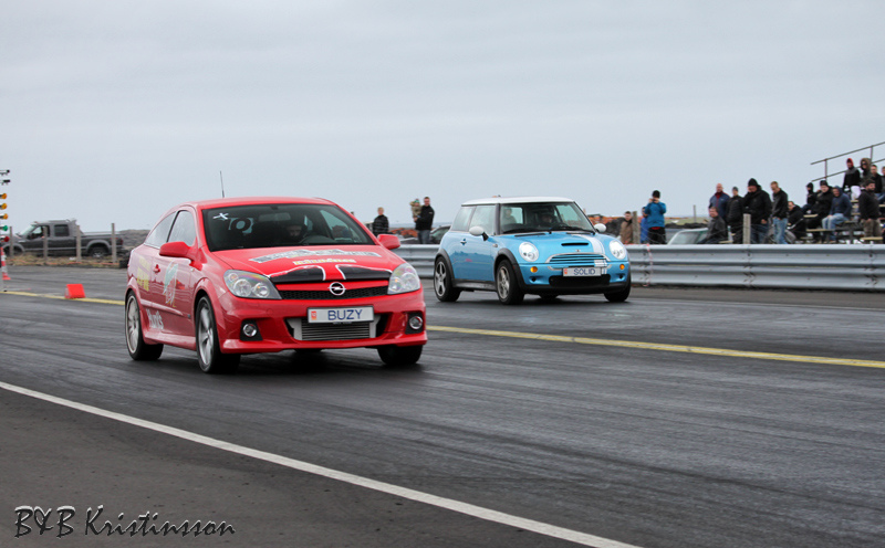

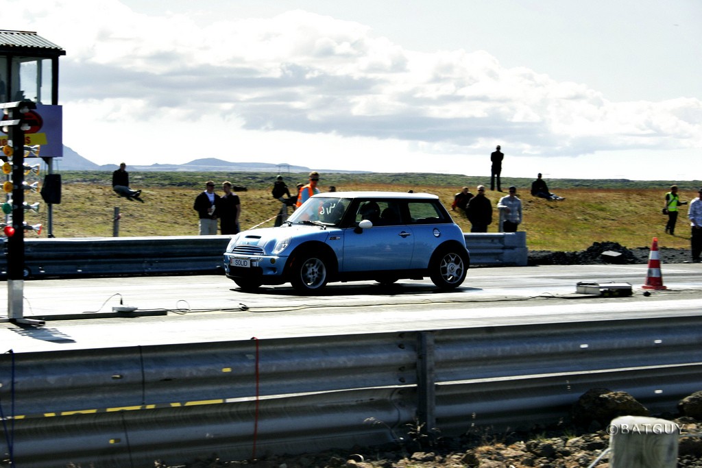

Went to the track and got 14.503 best on street tires.

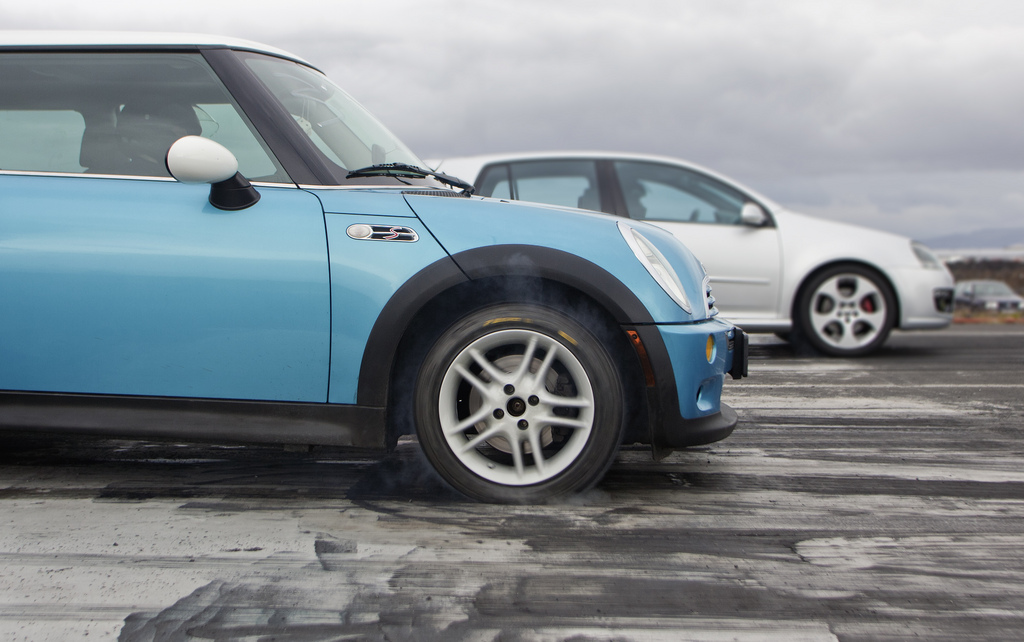

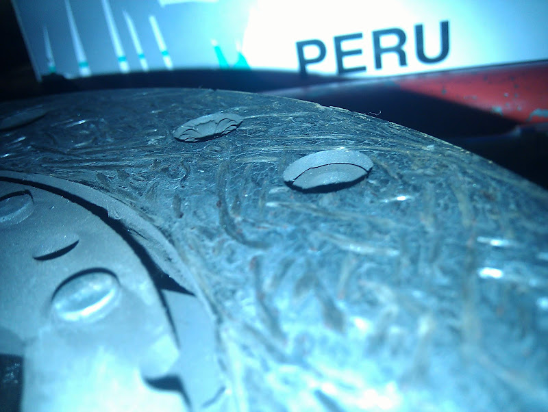

Got some slicks
Made them a little better
Then I ran 14.19 @ 98mph with the slicks on (I was hoping to get to 13.99)

Might seem like a silly question, but with slicks, did you do some proper warm ups? What compound are the tires? While doing all that tire tape prep, a little medium to fine grit sand paper would have done wonders for all that rash, but I understand they are track beaters.
