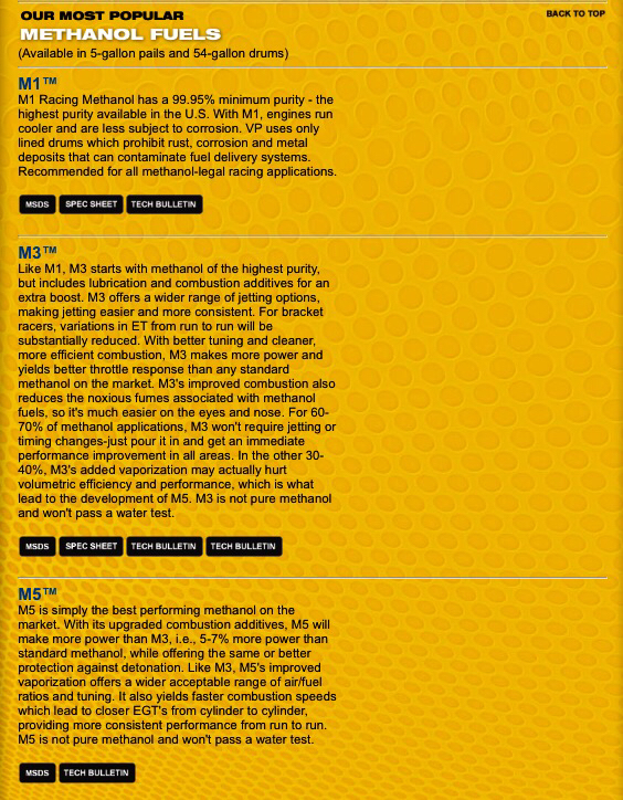

Does M1 come in different octane?
M1 is only one, but VP makes a few different M's in Methanol here is a a screen shot

A quick search on-line will return all kinds of answers, but according to The Society of Automotive Engineers specification SAE-J1297 the octane rating for 100% pure alcohols is as follows:
Methanol - 133 (RON) & 105 (MON) - octane rating ((R+M)/2) = 119
Ethanol - 129 (RON) & 102 (MON) - octane rating ((R+M)/2) = 115

$37 per gallon. Be very careful on which methanol blend you run as some kits won't work with additives. The M1 is 99.95% pure methanol. The M3 and M5 products have petroleum distillates added. If you run either of these in an Aquamist system it will fail, as the seals are not compatible with petroleum products. You can tell if methanol is pure by using an eye dropper and adding a drop of water to it. If it is not pure you will see a small cloudy appearance when the drop hits that will then quickly disappear.

I run methanol in my sprintcar. When im not running in the 360 class i re-jet for the M5 fuel and run in the 410 class. 55 gallons of pure is $125 up here. 47 dollars i do believe for the M5, but the price changes so much on it. The M5 has ALOT of oxygenated additives in it that 90% of racing divisions do not allow. That being said, tigger im gonna make a new post for the next question.
