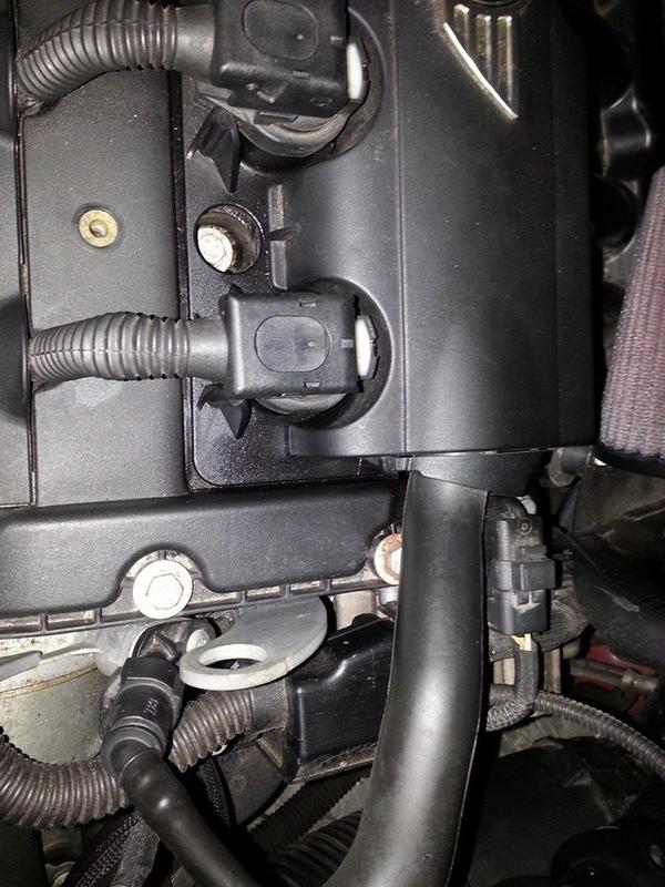

Could someone tell me what this piece is?
I was wondering if someone could tell me what this piece is? I was changing the oil last night and was looking around the engine bay for anything a miss. Came upon this piece with a tear in it by where the intake shroud fits. Wondering if it could cause anything? Vacuum leak? Anything like that. I ask cause I have the dreaded P115c CEL and have already replaced the MAF and also sprayed Carb & Choke cleaner around the valve cover... MAF area... PCV valve area on the valve cover...inlet area with the inlet connects to the turbo.. etc. The revs didnt change one bit. Not really interested in throwing a grand at the problem for it to still be there like so many have in the past. My only other guess is that maybe its carbon buildup related? Last time I seafoamed the car before revving the car this (PIC 3) was on the ground before. Any help would be greatly appreciated.

Looks like that is just wire protection. I wouldn't thinks a tear in would be of any concern, unless the wire inside is damaged.

+1 is the wire protection for the main engine bay wire harness. Just make sure not of the wire inside of it are damaged or scraped. Check the connection all to the valve cover and while you are at it check the connection from the valve cover to the intake boot. Also the intake boot fro crack , splits down near the turbo.

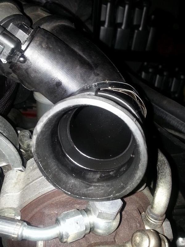

Check the bottom side of the connection to the turbo from the intake boot. You will see cracking. For the valve cover , loud hissing noise ( off a hairline crack that's larger with heat) , or in the early days there will be oil residue on the valve cover that continues to show up, mostly on the center position. Check all those connections I posted above, like back side hose ( check for damage leaks ) from the valve cover to the intake manifold.

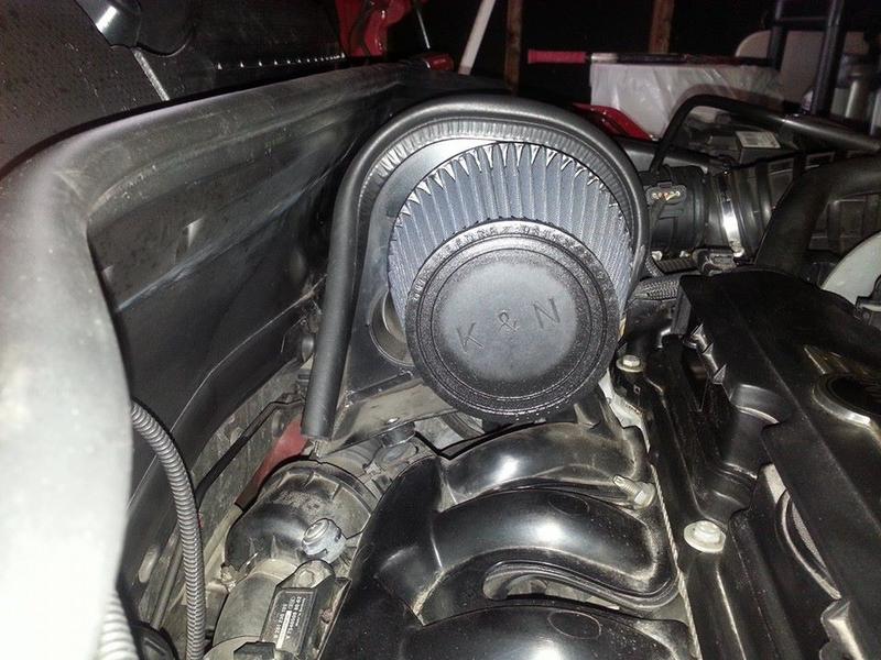

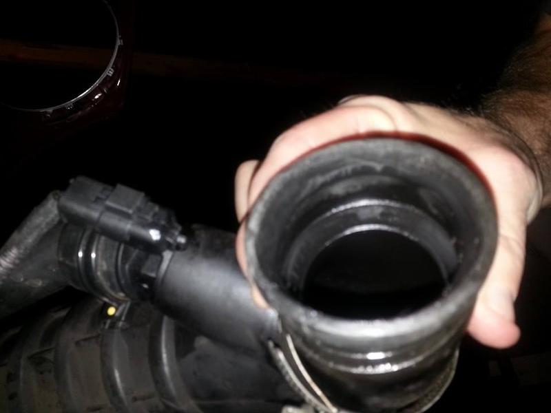

Undid the inlet from the turbo and the MAF to try and see if I can see any splits...rips...tears...etc and have found nothing. The inlet would've made the much sense cause back when I installed the intake I was having trouble with the inlet staying on the turbo. But retightened it and since havent had a issue with it coming off. Was pretty snug on the turbo. I have 0 hissing coming from the car when I shut her off and no oil spots (besides the 1 spot that I accidentally spilled some one time) on the valve cover. The only other thing is the back side hose and unless I have the Alta CAI installed incorrectly then I dont know what else it could be. I have included some pics of how I have the intake installed and some pics of the inlet where it connects to the turbo. Looking at pics of the Alta intake installed I dont believe I have it installed wrong. The bottom piece that connects to the intercooler pipe is suppose to not connect onto anything right? I'm really just about to give up on trying to track this down.
