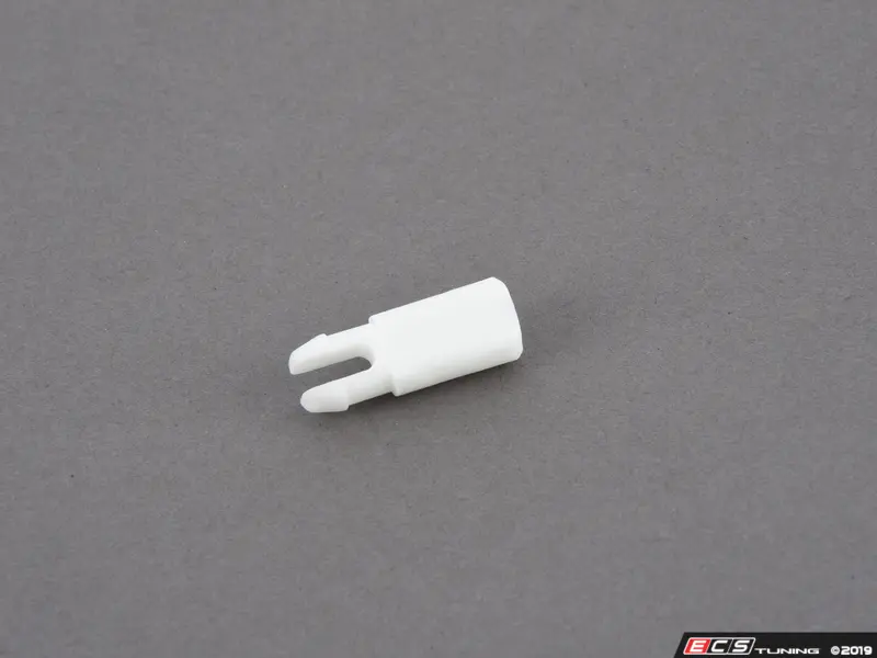

need helps identifying part 13 on the clutch pedal assembly

Hello everyone,
I'm looking for part #13 in this diagram. Mine is in pieces. Any help would be appreciated. Name, part number, a link to a seller, whatever.

https://www.realoem.com/bmw/enUS/sho...diagId=35_0313
number 13
Master Cylinder Pin
https://www.ecstuning.com/Search/Sit...h/35311163874/
