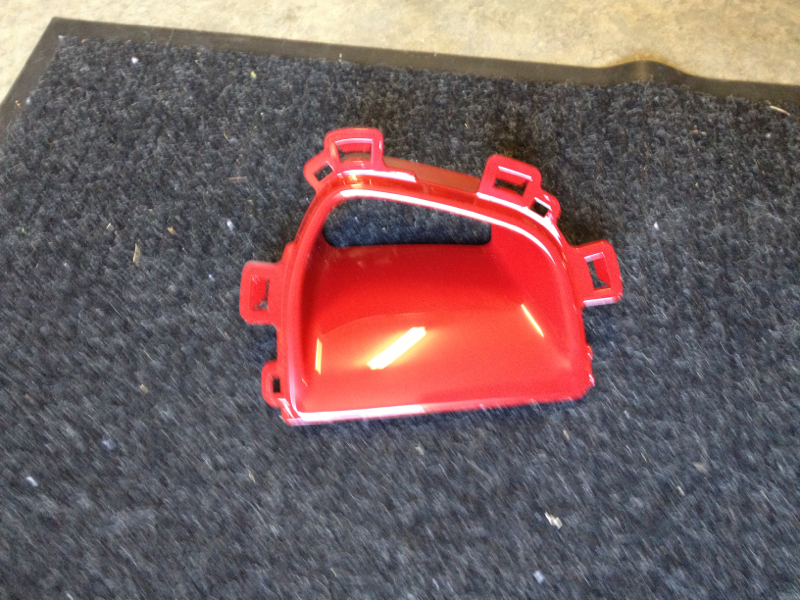

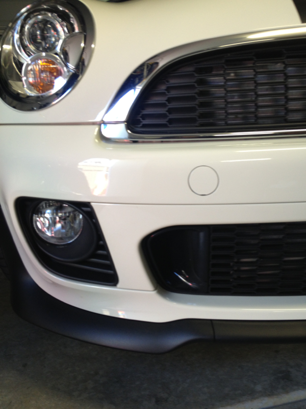

I am talking about this:

Take off the front bumper. If that's all you need replacing...
Look for a front bumper removal guide such as an intercooler install guide. It'll have the initial part you want on how to remove the front bumper. Once you remove it, you'll know what to do to swap out the duct itself.

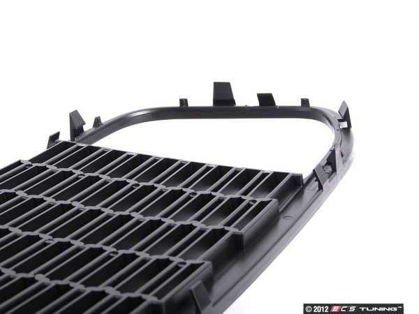

Yea, you have to take the bumper panels off the with grille and ducts snap into in on the back side.
Here is the side of the lower grille. Which snaps to the bumper with the ducts.
Here is the JCW front bumper diagram. For the newest design JCW bumper. Like found on the GP 2
And the Red JCW GP 2 Ducts. Part number 51747330891KT which goes in location # 7 for the old ducts.
