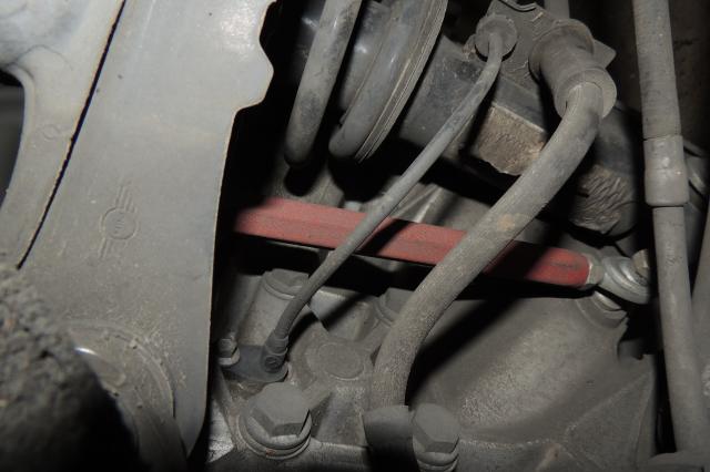

Could you post a pic or two of how yours are installed? Would like to compare!
I'll try and get a pic. in the am for you USCooper!!

Not great pics...

Thanks for the pictures, RJ. Turns out mine were installed correctly (as suspected) but a bolt came loose and was causing the clunking (really sounded like a box of marbles and sticks under the car). Had it tightened with some locktite and no noise since.
