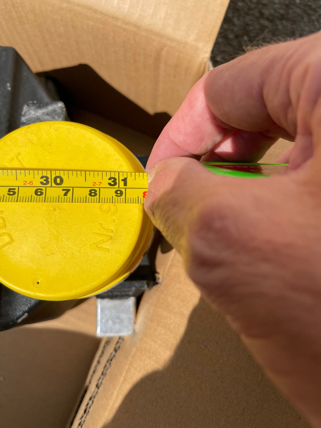

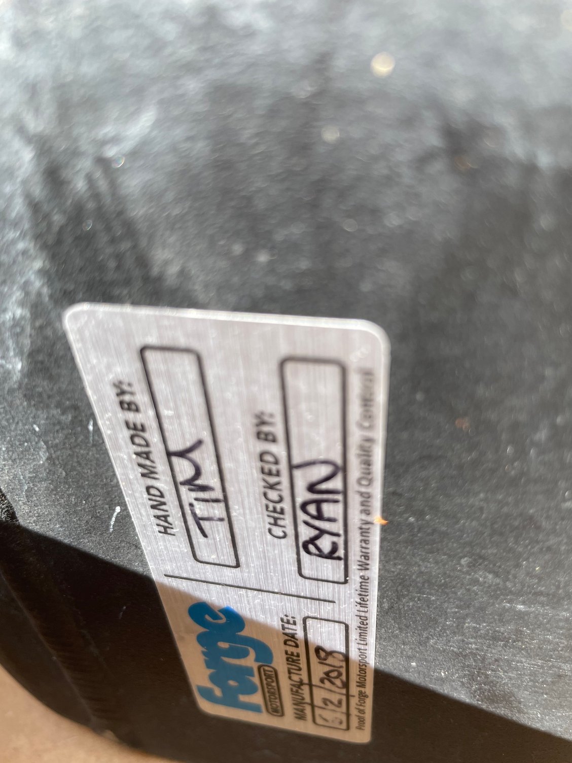

hope these images help, unfortunately I got my intercooler second hand about 5 years ago, and it sat on my garage floor until last summer
Obviously manufactured before the facelift, so to my knowledge there hasn’t been any upgrades from forge since.
is it just a case that most Lc2 facelift cars will be still under warranty until last year so not that many will have been extensively modified
so not a case they won’t fit, but more that no one had actually tried ?
mine was April 2022 build, and used as carbon wurks shop/development car
last video, but there will be be 24 other proceeding ones that detail most of the build before I got it
I’ve since added, kw v3, the forge intercooler, the ecu holiday in Finland derv-tech roller/dyno tune, BBS RC wheels and other stuff I can’t remember

UPDATE AND GOOD NEWS !
For any F57 JCW owner following this thread, I have a confirmed solution.
So here's the deal: The facelift F57 JCW (and maybe even the earlier ones?) do NOT have the same ic as the F56 JCW. OEM is the much smaller F56 "S" ic.
i was pretty upset when I found this out. (To put it mildly.)
Looking for a solution, I ordered the racing Dynamics 137 30 56 400 that Triman used. Unfortunately, my mechanic said there was no chance whatsoever of making it fit, unless I wanted to completely rebuild / rework my car's front end. Turns out that the f57 doesn't just have more bracing, but also a different radiator, different fan, etc. Ughh.
The guys at racing Dynamics took a look at my mechanic's pictures and measurements, and sent me a smaller unit to try. That is their ic # 137 30 56 300. (And I have to say, the customer service at Racing Dynamics is amazing. They even shipped the replacement first, and paid for shipping of both units as well.)
My mechanic said this one will definitely fit, with some "minor' mods, like re-routing a hose, and so forth. SO THIS ONE WORKS.
However, while I was working that out, I also ordered an ic from Wagner that they said MIGHT fit. It is the Wagner #
200001076. This ic is slightly smaller than the "good" racing dynamics ic abaove, but still MUCH larger that the OEM F57 JCW one. I can report that it is currently installed in my car, and looks like a factory fit. WooEEEEEE !!!
So there you have it. Two choices that will absolutely work. Just be prepared to do (or pay for) a bit of modification work. For track use, I'd probably go for the RD, and it costs less, to boot. For street use, I'm sure they both are more than anyone could ever need with a stage one tune.
