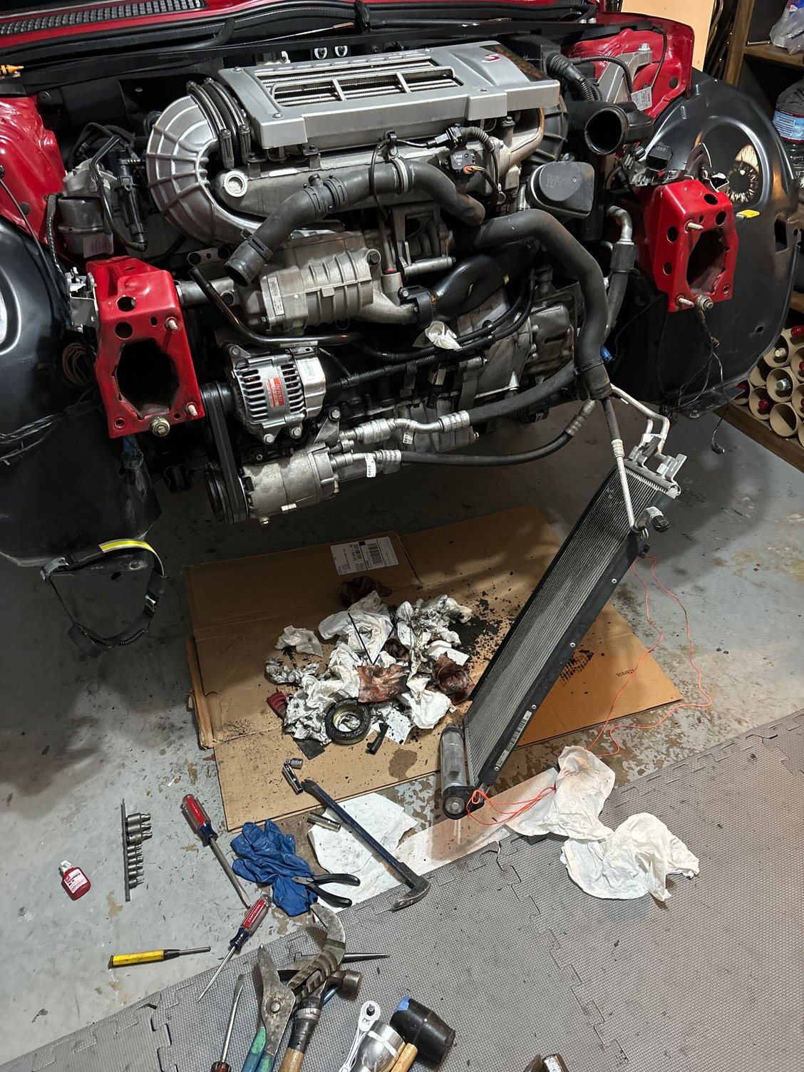

Not only did I discover she’s a factory JCW with limited slip but someone has been busy installing a new alternator.
Alternator
Now that the AC compressor is accessible I can replace the clutch coil and do some cleaning. There’s a mess on the radiator side of the engine.

What an oily mess.
The crank position sensor leak created a huge nasty mess typical of British cars from the 1960’s. After an hour of cleaning I got the AC clutch coil installed. It was a bear getting the pulley off and was time consuming. Hopefully it will hold vacuum and will be go for recharging.
The crank position sensor had to be excavated out of the oily dirt accumulation with a large screwdriver and a putty knife. I certainly don’t want another BMW o-ring since it’s a guaranteed failure after 5 years. Am I pissed about a $.10 part?
Anyway the project is moving forward.

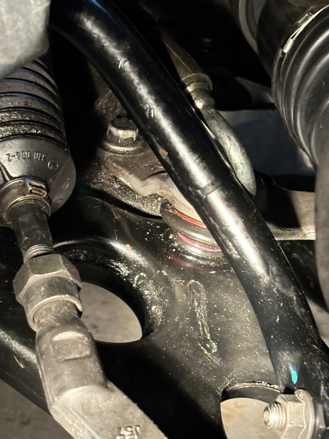

Power steering Line
The power steering line is touching the sway bar.
It appears to be routed through the guide with rubber protection on it.
Is it supposed to be on the other side of the rubber?

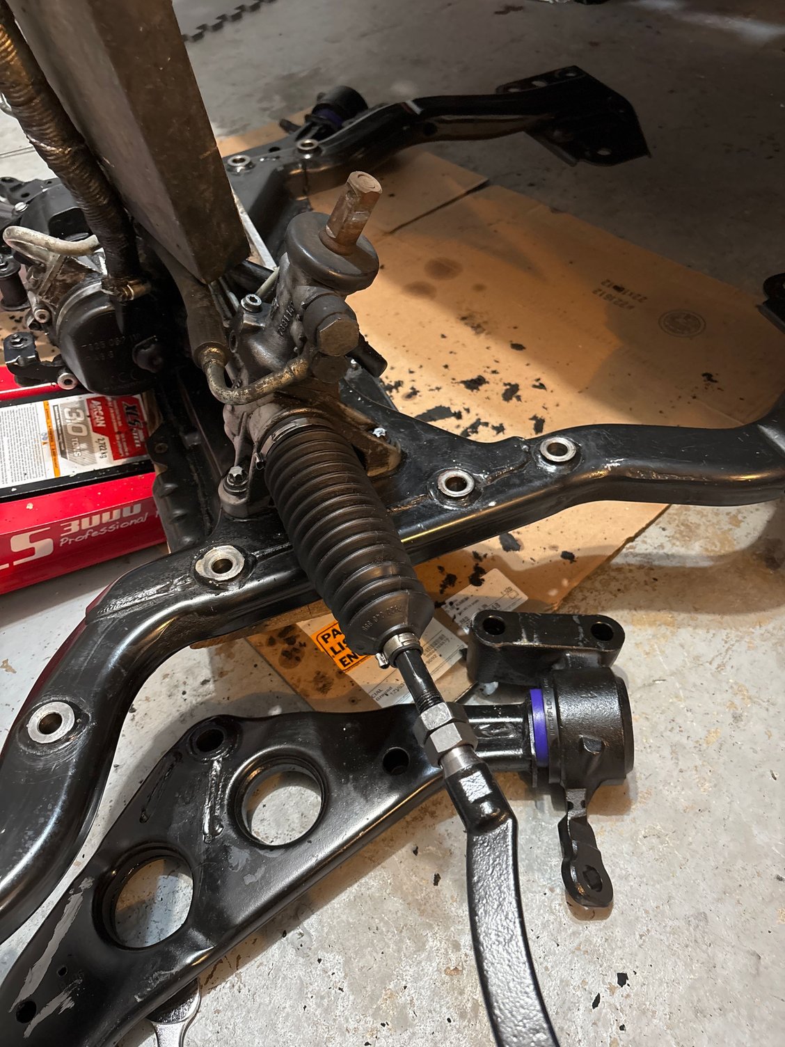

Dropped the subframe
New tie rod inner and outer
Old Oct 29, 2024 | 07:02 PM
Krunch2020's Avatar
Krunch2020
Joined: Aug 2024
Posts: 51
Likes: 18
From: San Anselmo, CA
Power flex control arm bushings
Control arm bushings and tie rod ends.

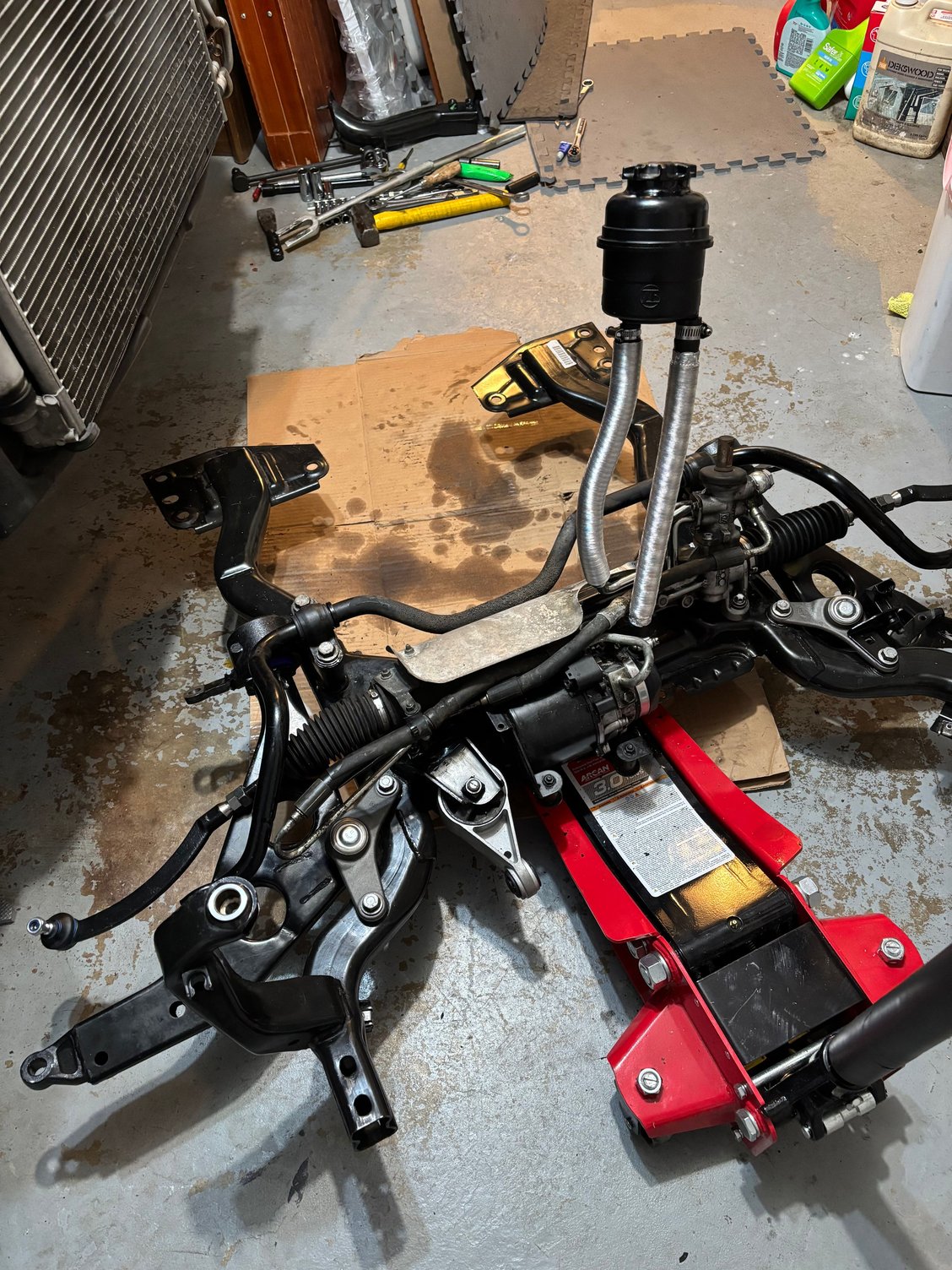

Subframe ready to reinstall
Subframe with new inner and outer tie rods, inner ball joints, new power steering hoses, control arm bushings.
