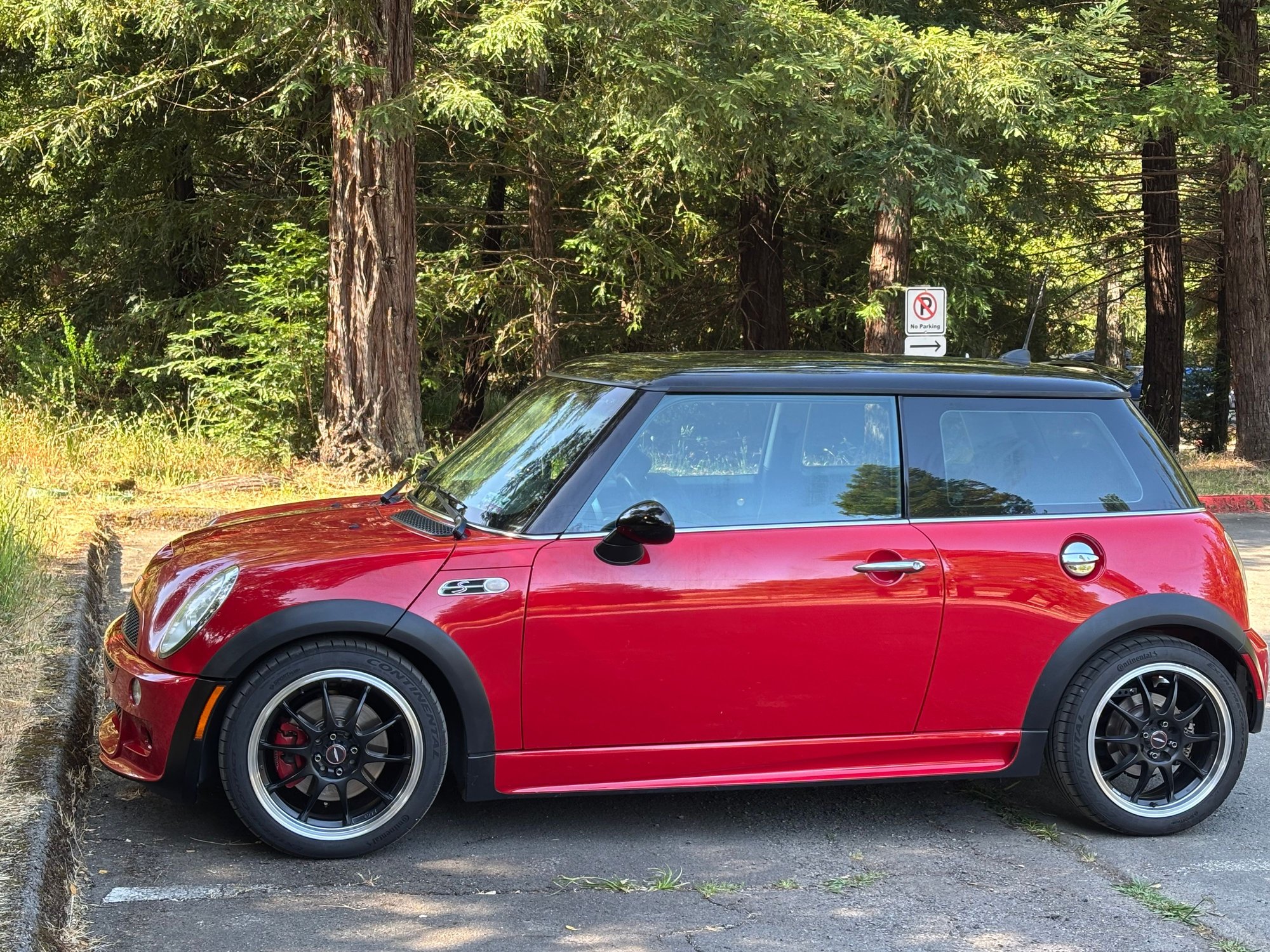

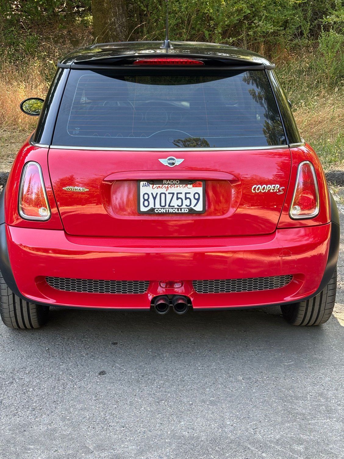

Project Completed
The test drive was great! Suspension is nice and quiet and seems more balanced with the 20mm Whiteline rear sway bar. I’ll get the fender liners back in and call it good!
Chili Red by a Redwood Tree
JCW Rear End
JCW Rear End

Nice Car

That is what exactly what I want to do .. I need to find a good stock mini so I can enjoy doing the modifications. Great job....
