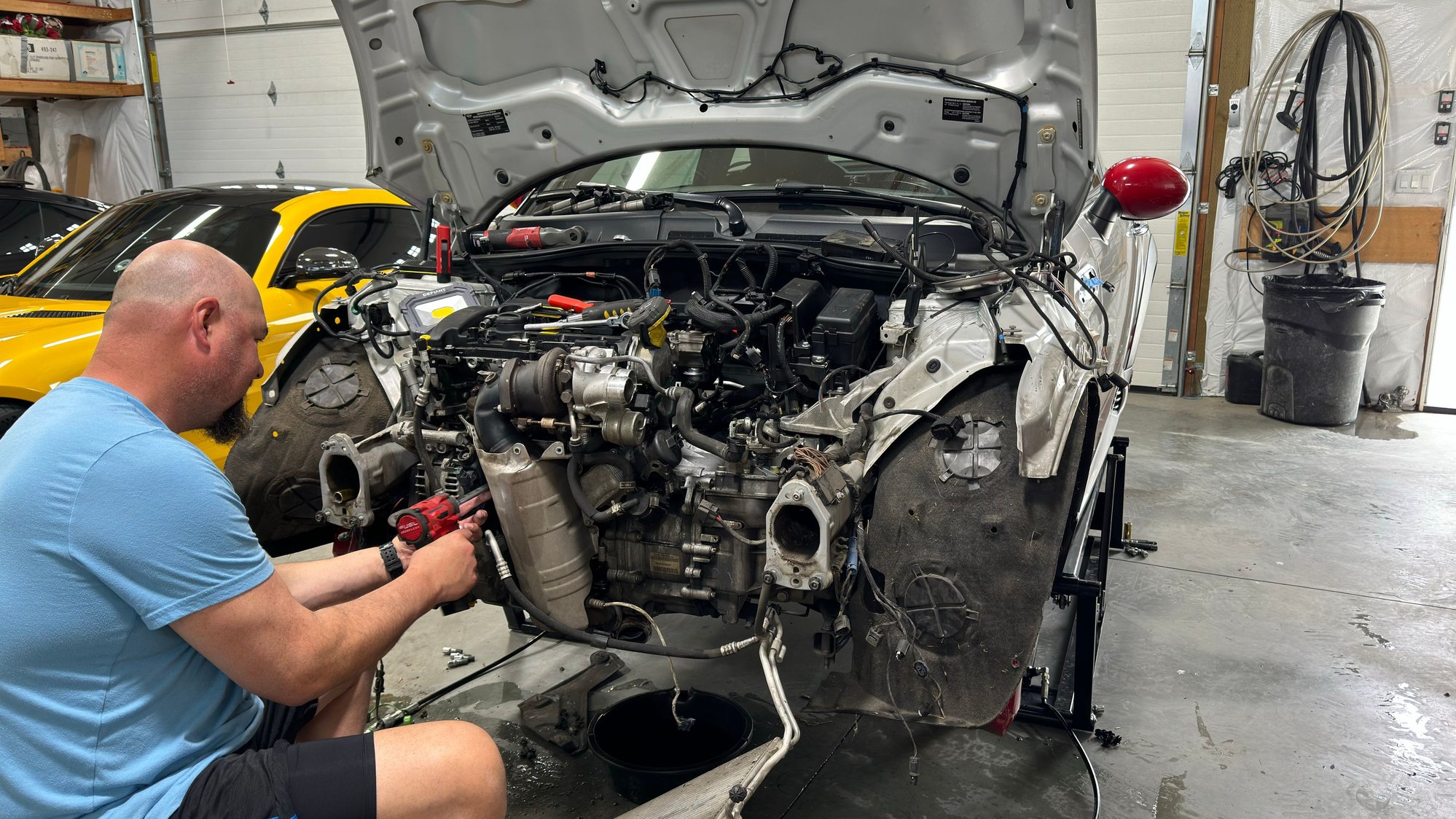

Got it on quickjacks last night to see see location of leak just to track it down. Top of transmission is dry. Under the car found location of dripping. It's coming off the front of the motor behind the downpipe, then dripping off the transmission case.
I pressurized the system and the dripping got worse, but I can not locate for the life of me.
Any ideas? It almost seems like oil cooler or the turbo coolant outlet line from location, but haven't seen any threads on here for that.
Regardless, today I ripped out the t-stat housing and crossover pipe and ordered the aluminum ones (t-stat and pipe) from ECS. I also ordered a new water pump with metal impeller as I can see it still has plastic one installed. New valve cover coming too, silicone coolant pipes, and a intake resonator pipe delete. Since it's getting tore apart, might as well right?

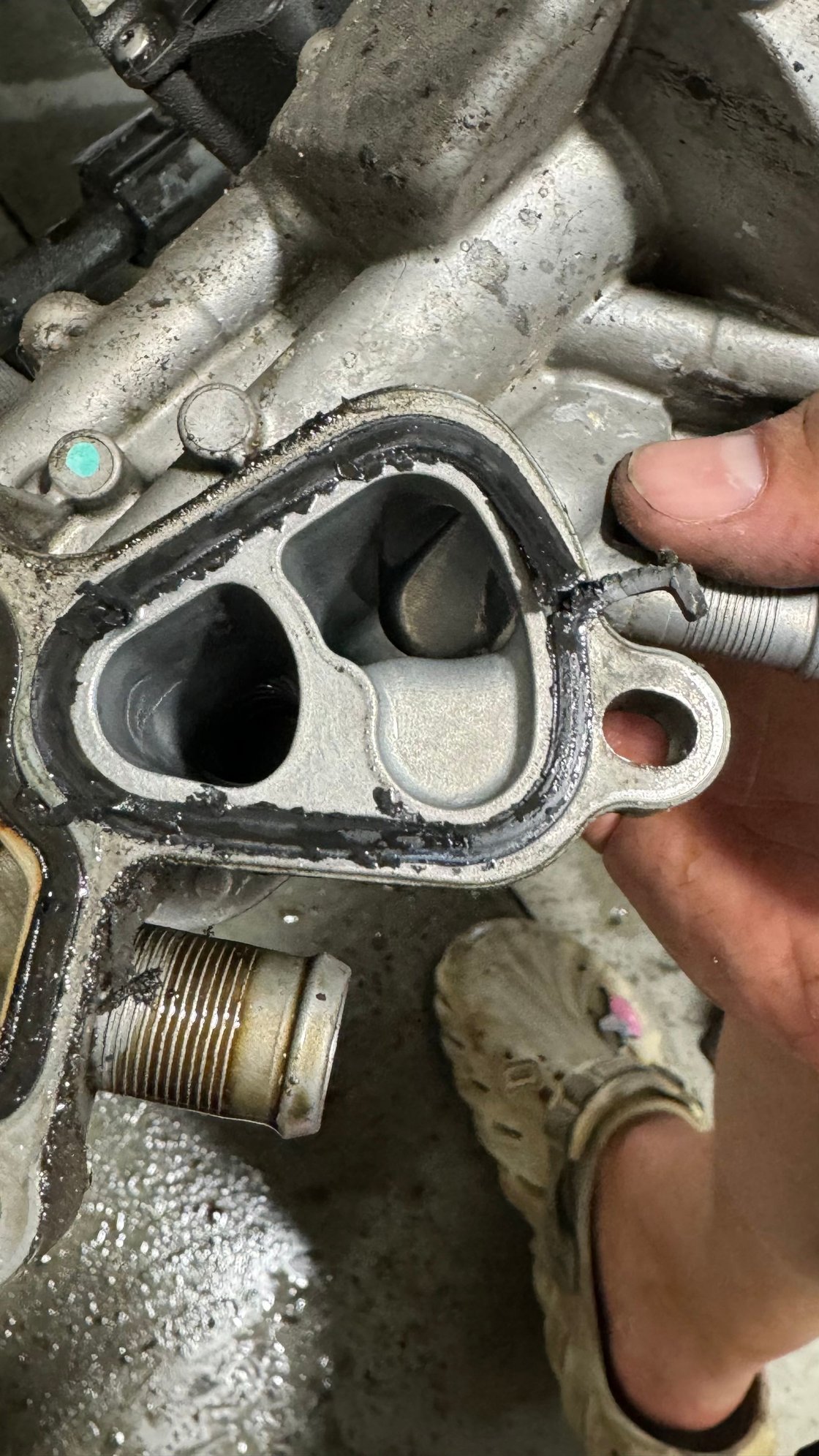

Oil filter housing/ coolant seals. Thats my guess.

Down pipe will have to off as well as the DP heat shield.
https://www.northamericanmotoring.co...placement.html
https://www.ecstuning.com/Mini-2012-...s_-and-_Seals/

Just an update on this...ECS was right. It was the oil cooler gaskets. Also discovered turbo oil supply line was loose. Guess this was all a good thing in the end.
