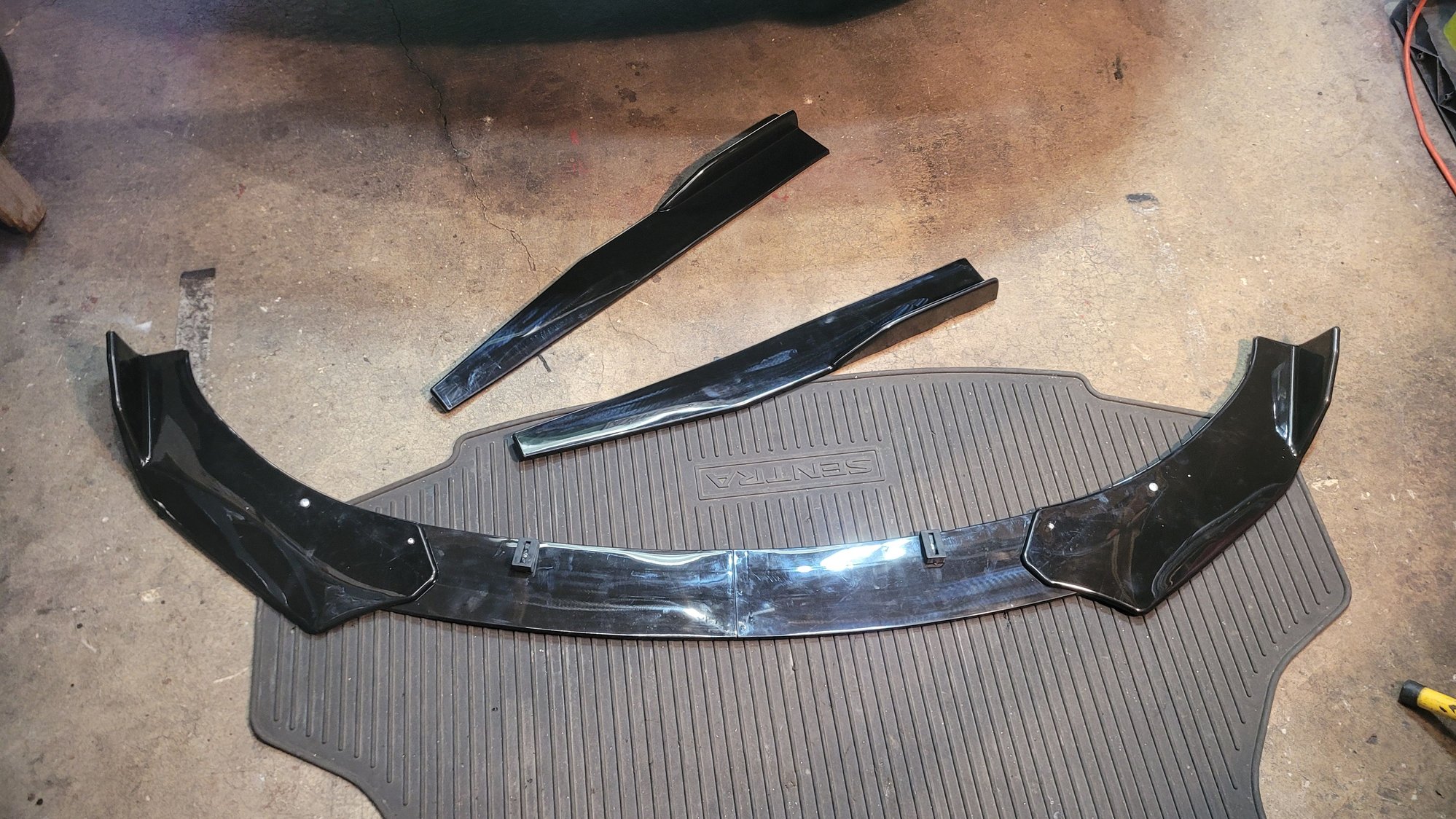

Here a link to the flares I used... they look nice BUT they're very cheap , very thin. But they mount very firm and very stiff so unline the 500$ front lips , I bet I can go over 100mph no problems atleast !
i began putting in my Unionjack lights too along with leds.

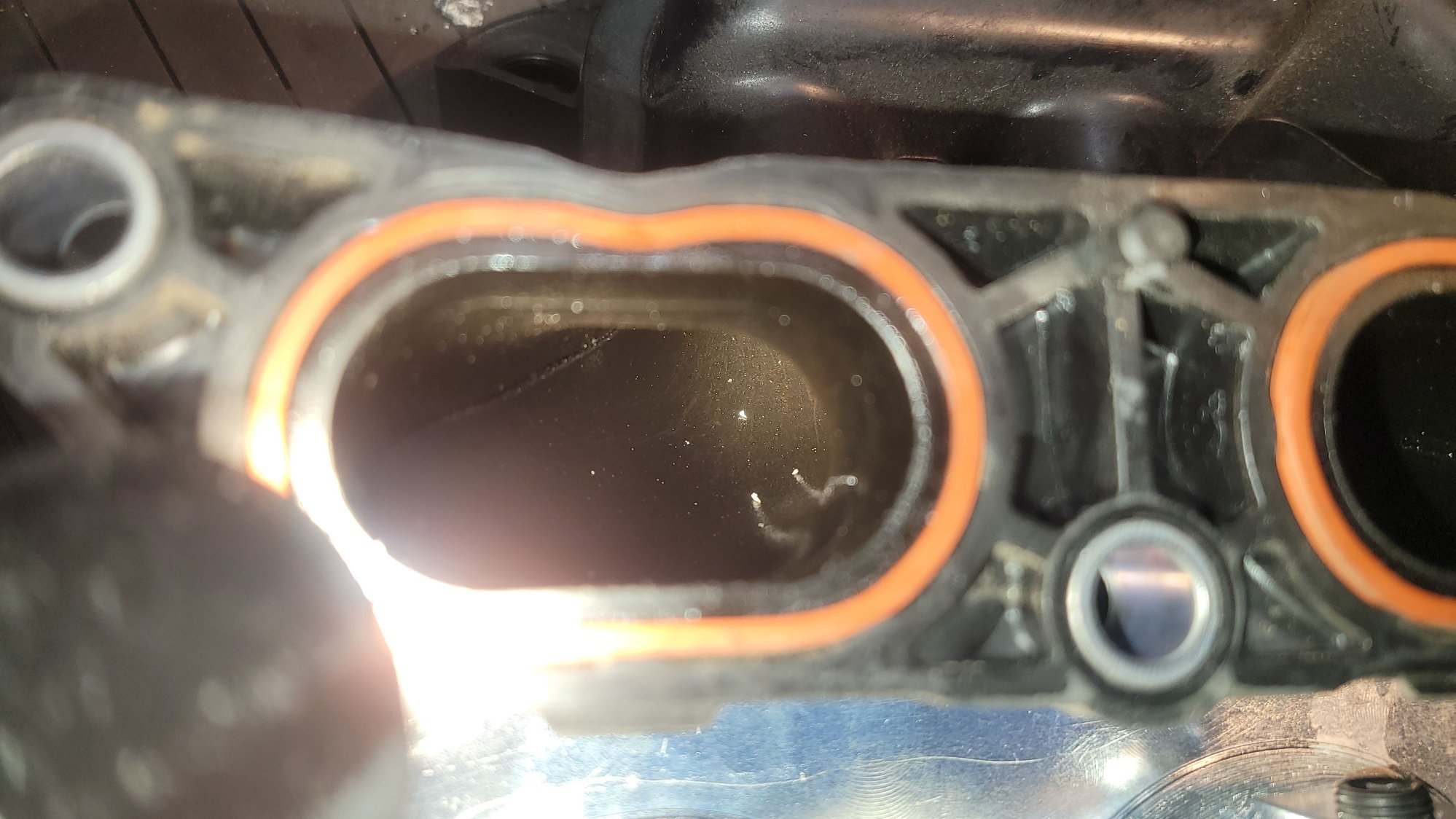

Looking good Adam, if you do the walnut blast are you gonna slap a catch can back in there? I saw it in the early stages but then you deleted it, looking at this engine bay is like studying martian terrain to me, I kinda know what I'm looking at but some parts I have no clue what's going on What catch can was that btw? I'm looking for a lighter, aluminum one to replace the heavy chromoly can that's in use now and have about 700 miles before the next oil swap. Congrats on the fam-court win btw !

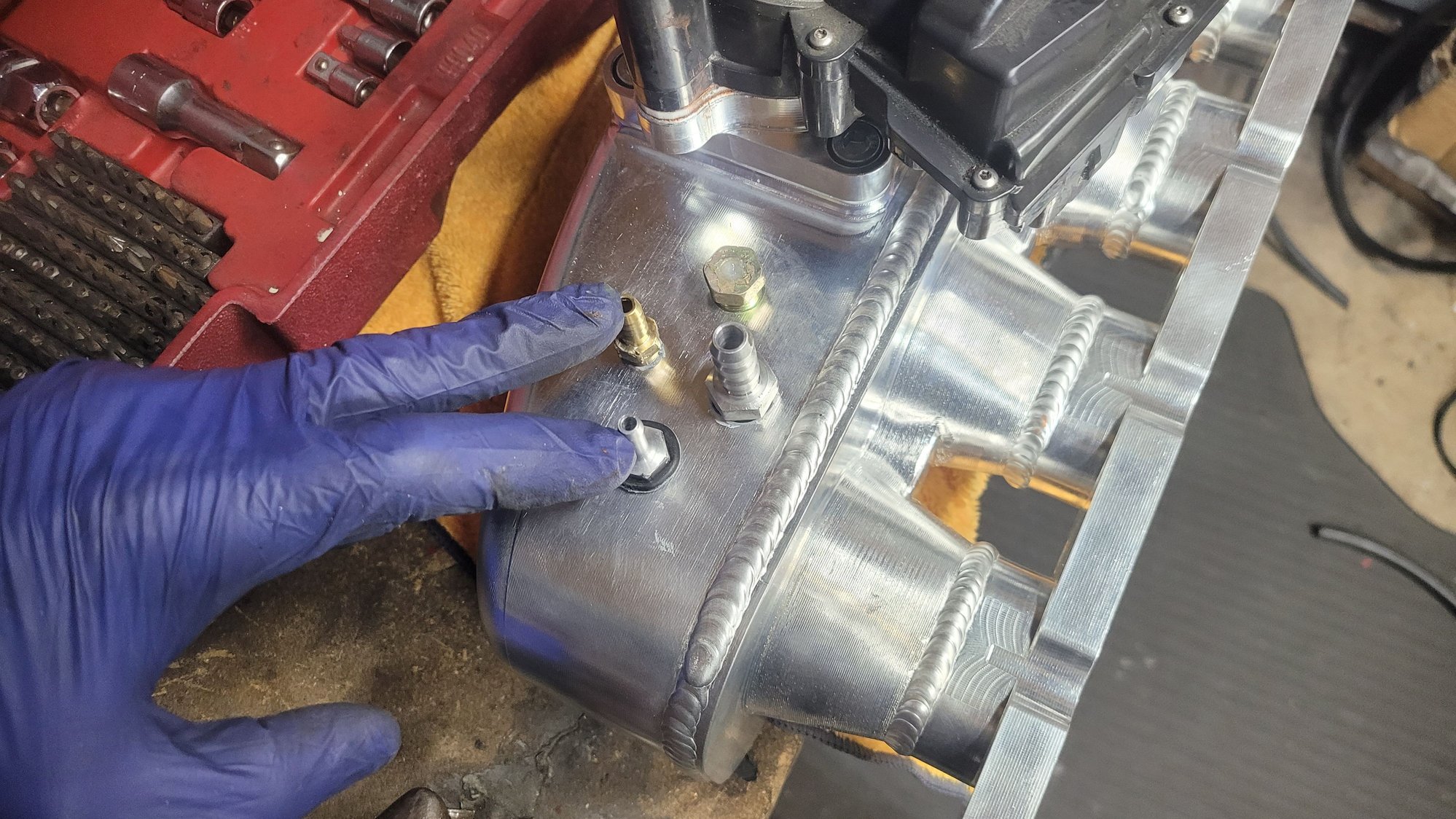

yes I am.. I had a custom intake made to fit my turbo and be able to route in a catch can...
it's taken some getting used to for me also but I'm quickly learning about turbos..

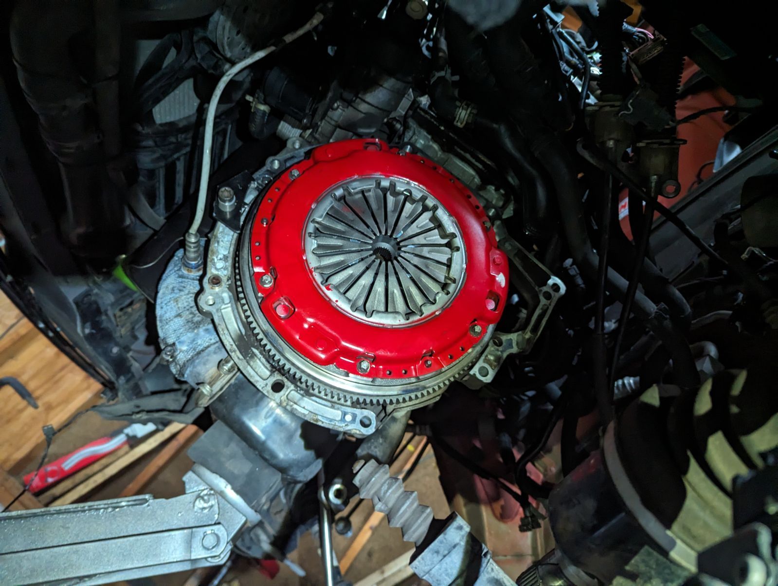

New rearmain seal , throw out bearing , dm flywheel , pressure plate and Clutch are all in !
once he has the car back together then it will be walnut blasting time for the valves and then I will jet out there and pick it up and I actually plan on taking backroads the WHOLE way back home to start breaking in the clutch. It's about 40miles away direct shot freeway so doing stop n go on side roads will be probably about 50miles and take probably 1hr-1.5hr and that should be a GOOD start to breaking it in. It requires a 500mile breakin period so I'm going to do it just like I did with my r53's. Lol it's gonna be hard not to just romp on it and feel it out because I'm really really gonna wanna and feel if the valve cleaning helped at all ( I don't have any idle issue or loss of power or cel ) but I just wanna make sure...

Awesome, buddy finished the clutch job and due to incoming storm , I'm going to puck it up now 1030pm and we're due for upto 8in tomorrow..
the valve blasting will have to wait BUT wait until you see the move I made instead...
I will update tomorrow how the new clutch feels n stuff..

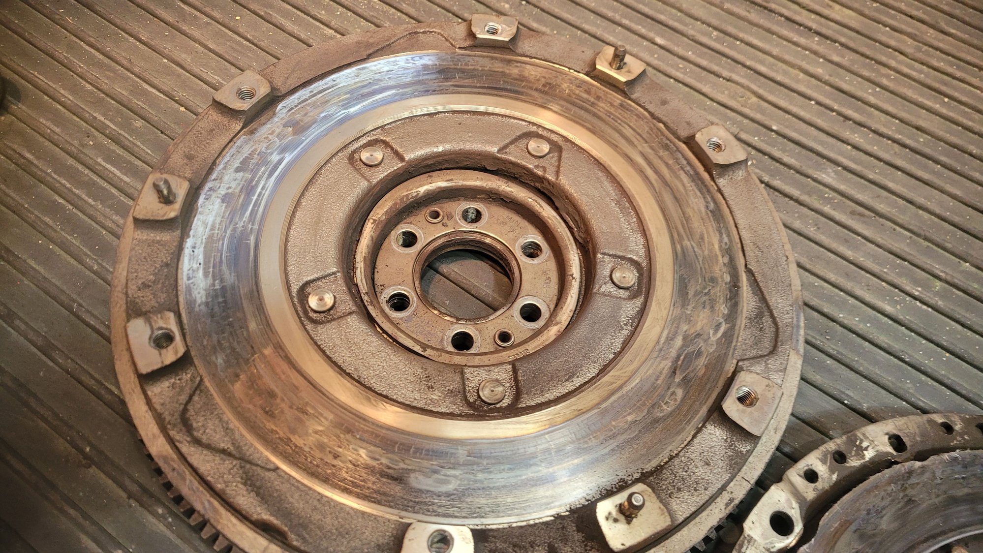

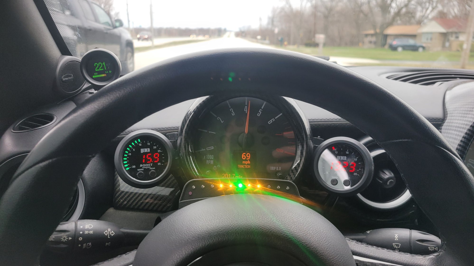

Lol and look at these pic , think my clutch was being over powered??? Lolol and NO , I know how to drive manual and drive it VERY well too. This is unfortunately what happens when you probably put close to 2x the power through a clutch than it was designed for..
I gotta get a video up soon showing you guys how well this car pulls.. I still cabt believe I don't need to down shift on freeway when passing , or in any gear for that matter , once it is at full spool which takes literally 2seconds only after going full throttle it feels and pulls as well as if i had down shifted and raised the revs too befor dropping it into gear to pass...

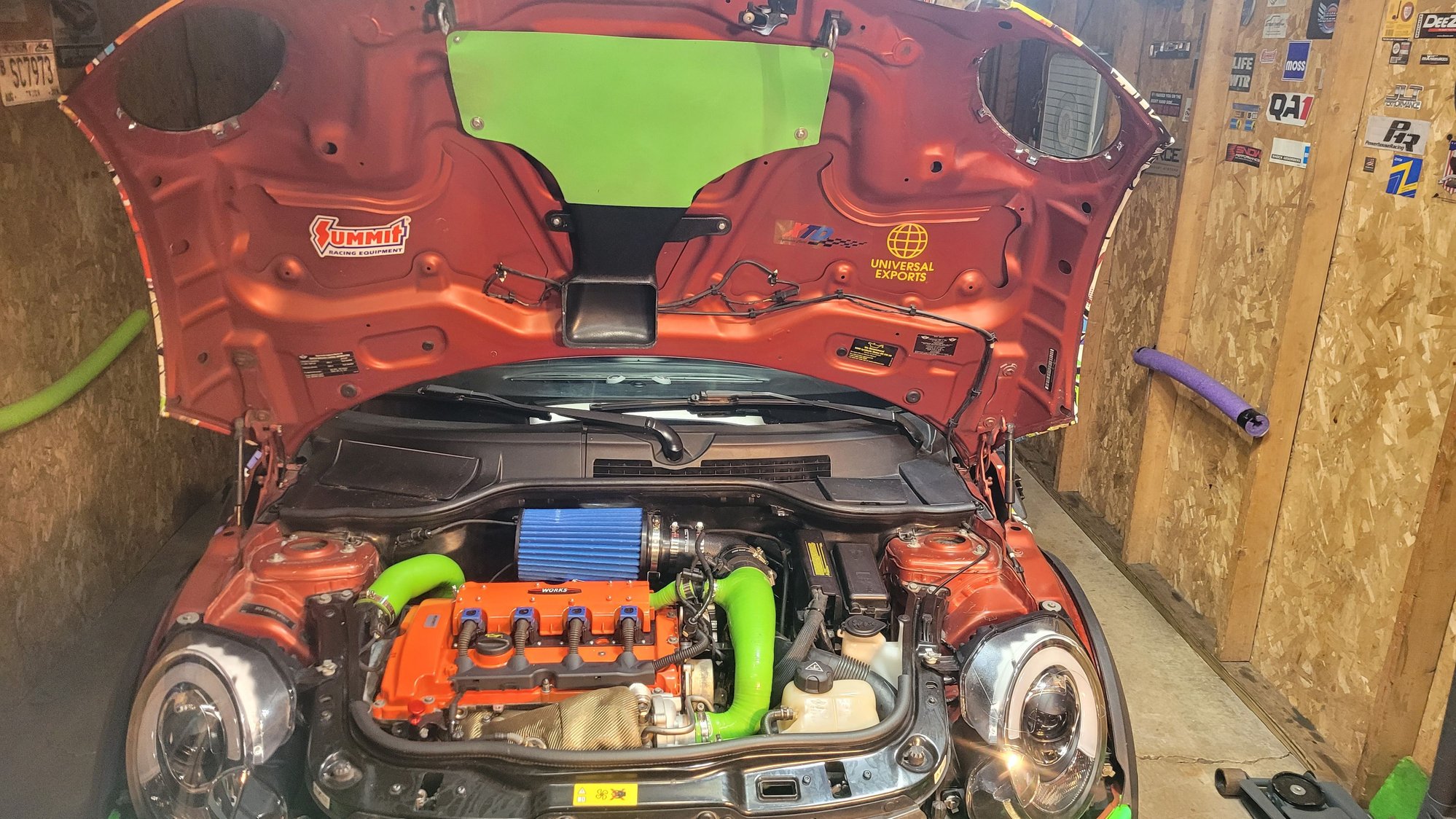

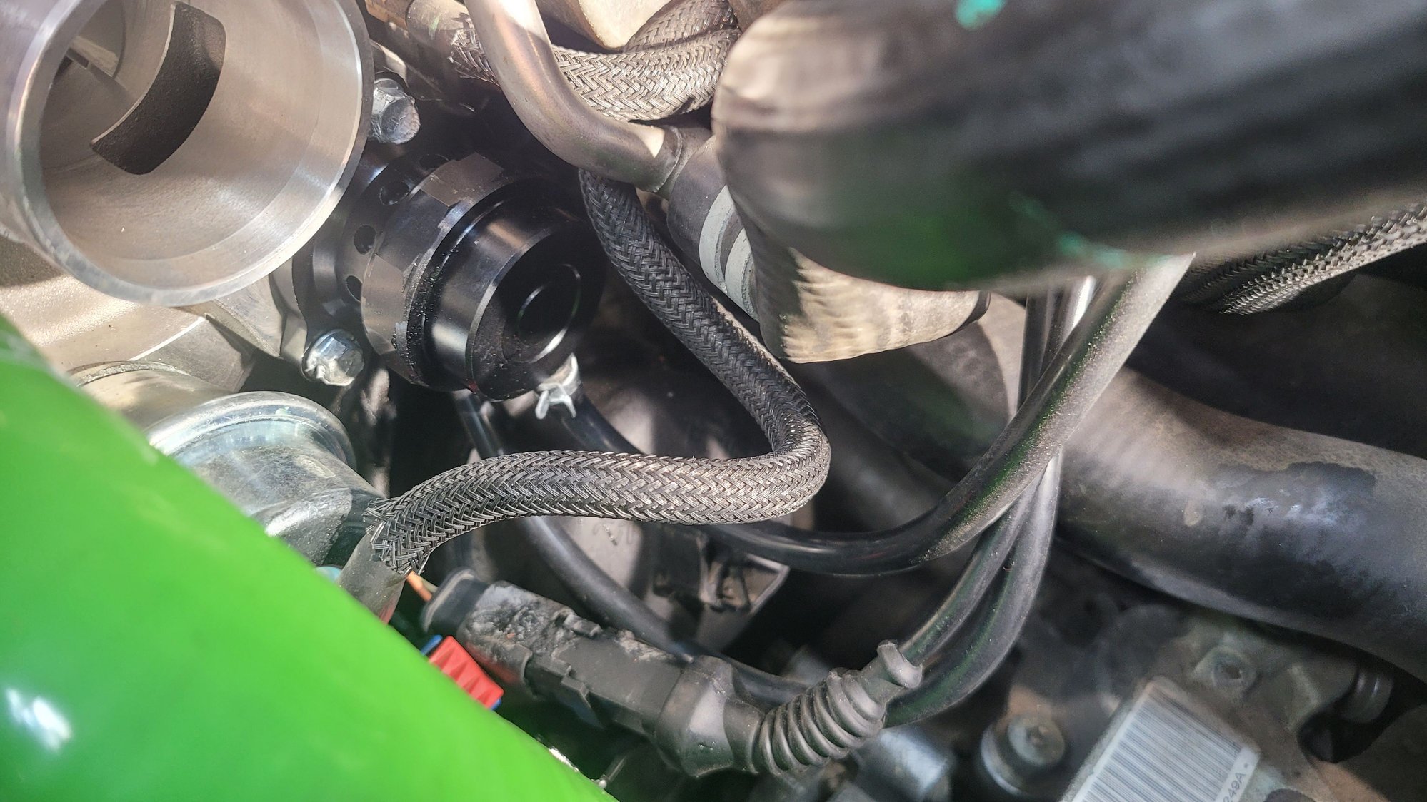

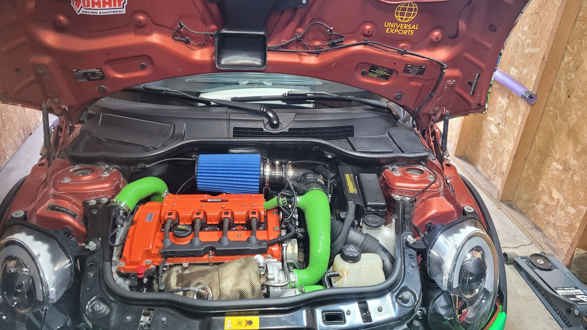

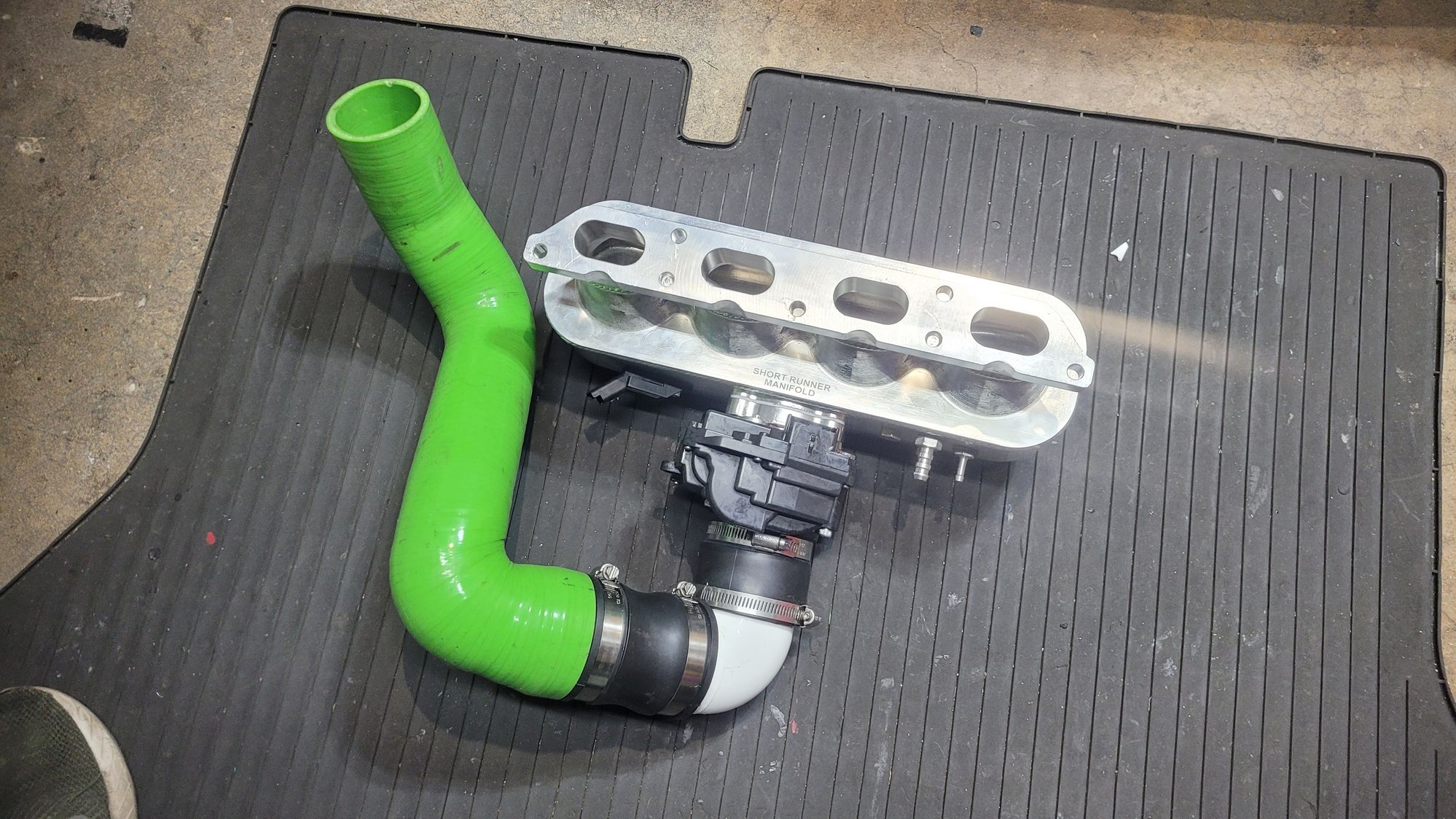

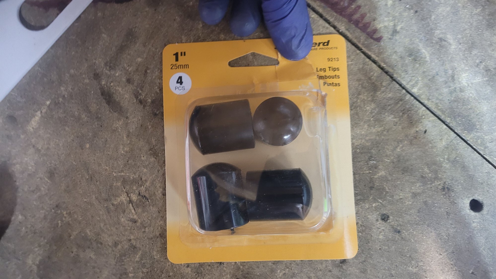

Not decided yet what I'm going to do about this transmission noise and excessive chattering. If it no better at the 500x mile breakin period. It's ALL gonna have to be taken out , shipped back and gonna have to bite the bullet and go full clutchmasters 1x piece lightweight flywheel then. I'm almost positive it's a janky throw out bearing because other than the noise , there's no other issues really..
so I been getting the billet manifold figured out and I had to come to family get together today but after I get back home tonight I'm HOPING to have the manifold on and tested. But I will also have to finish figuring out routing because of the throttlebody has changed angles.
I am deleting the passenger side pcv and I found i believe are barstool anti scuffers that once heated up barely fit over the valvecover exit and created a hella good seal.
i was fighting the manifold for abit until 1st I realized DUH I got my intake hose on still THEN I had to find the hidden 10mm bolt underneath WHICH YOU DONT need a wobble socket for , just use 1/4in extensions and push the flexbrakeline out the way.
my valves look pretty caked so I'm debating walnut blasting them my self because my bud just ran out of time when doing the clutch n stuff..
im also going to run dedicated vacuum sources for the boost gauge along with my bov reference so they dont alter one anothers reading by having to BOTH t Off of a map sensor adapter so who knows how that actually can effect the map reading if a vacuum source is being stolen from beneath it..
so here's some pics showing progress...
Old Apr 8, 2024 | 05:26 AM
  #125
MiniManAdam's Avatar
MiniManAdam
Community Builder
Joined: Jan 2020
Posts: 5,285
Likes: 709
From: OakCreek
Whoaaaaa !!! THIS MANIFOLD COMPLETELY CHANGED the power delivery on the car !!!
it lost abit of low end because of the big/short runners but not too much because the plenum volume is so large but the mid range/ top end OH MY GOSH ! WOOOOOW it picked up power and I mean like definitely definitely a butt dyno improvement, it barks the tires way louder and harder hoing into 2nd and 3rd than it ever has , the engine though.. idk ??? It sounds PRETTY LOUD with my intake setup, it literally sounds like a hurricane crossbreed with a hover vacuum. I had to remove my bov because I was chasing down a vacuum leak ( blew off boost tube because clamp failed ) but I got it figured out , with help of my daughter ( bout time she came out to help again ) and lol we were working at it from 1030pm till 300am. Lol she absolutely loves it also , we just went cruising around late morning then on empty city streets breaking in the clutch and e joking this noises the car now makes.. it ALSO will usually give 1x ONLY ONE decently loud POP too between shifts now..lol i LOVE it.. buuuuut heres the thing. I might leave the stock upgraded /new style bov because instead of a LOUDS phshhhh hisssssss from the bov the dv sounds like a sci-fi type noise instead ( kind of like how the cars sounded in need4speed or old forza) that chipy almost electric but yet mechanical bewbewbewbowoooo noise and its not as audible as the pshhhhhh hissssssss.
I get to return the useless 100$ worth of autozone universal intake stuff because good ole menards comes through YET AGAIN. The plumbing piping not only was 1/5 the price it also fits 2x better and didn't require any hackery or injunengineering..
I also cleaned up the throttlebody before reinstall, I used copper gasket spray on both sides of those teflon gasket things and i also heatsoaked the manifold and retorqued the nuts 3x times ( I'm **** about vacuum hoses). I really put in effort and took my time to route vacuum lines not just the cleanest way but also in a way so I can easily fix any vacation leaks tgat might occur, though I took extra care to use zipties and hose clamps ON EVERY SINGLE vacuum source , even the stock soft lines that are just pressed on like on the fpr , I used strong zip ties to better hold on all those type lines.
I took extra care to hang up the sensors under the manifold also so they dont interfere or chafe on anything.
I honestly expected install to be harder but I was pleasantly surprised. It just took so long because I took my time because I didn't wanna have to do anything 2x. though the boost hose blowing odd threw me a curve ball but that happened during the 1st initial test drive.
it probably a REALLY good thing I replaced my manifold too because as you see , the pic of the stock on on the inside of the throttlebody inlet , IT HAS A BIG INTERNAL CRACK !!! HOW ??!!?? IS that possible ??? So i guess these aluminum /billet /sheet metal intake all add more than just performance but also help reliability then too. Which imo it absolutely does exp with how it runs its vacuum setup.
also !!!! is it a known issue WITH r56's WHERE the throttlebody connection wires sheathing be filled with oil ?? It was like SOMETHING had leaked behind there at a time and it went rite into the harness and filled the plug full of oil , i found NO oil leaks nor do i have any so it may have bedn a prior issue that was fixed or maybe when I replaced the valvecover??? Either way , that DEFINITELY could have caused issues had what ever caused that continued because that plug more than likely would have begun shorting out or something.
pics Pics PICS !!!!!!!!!
