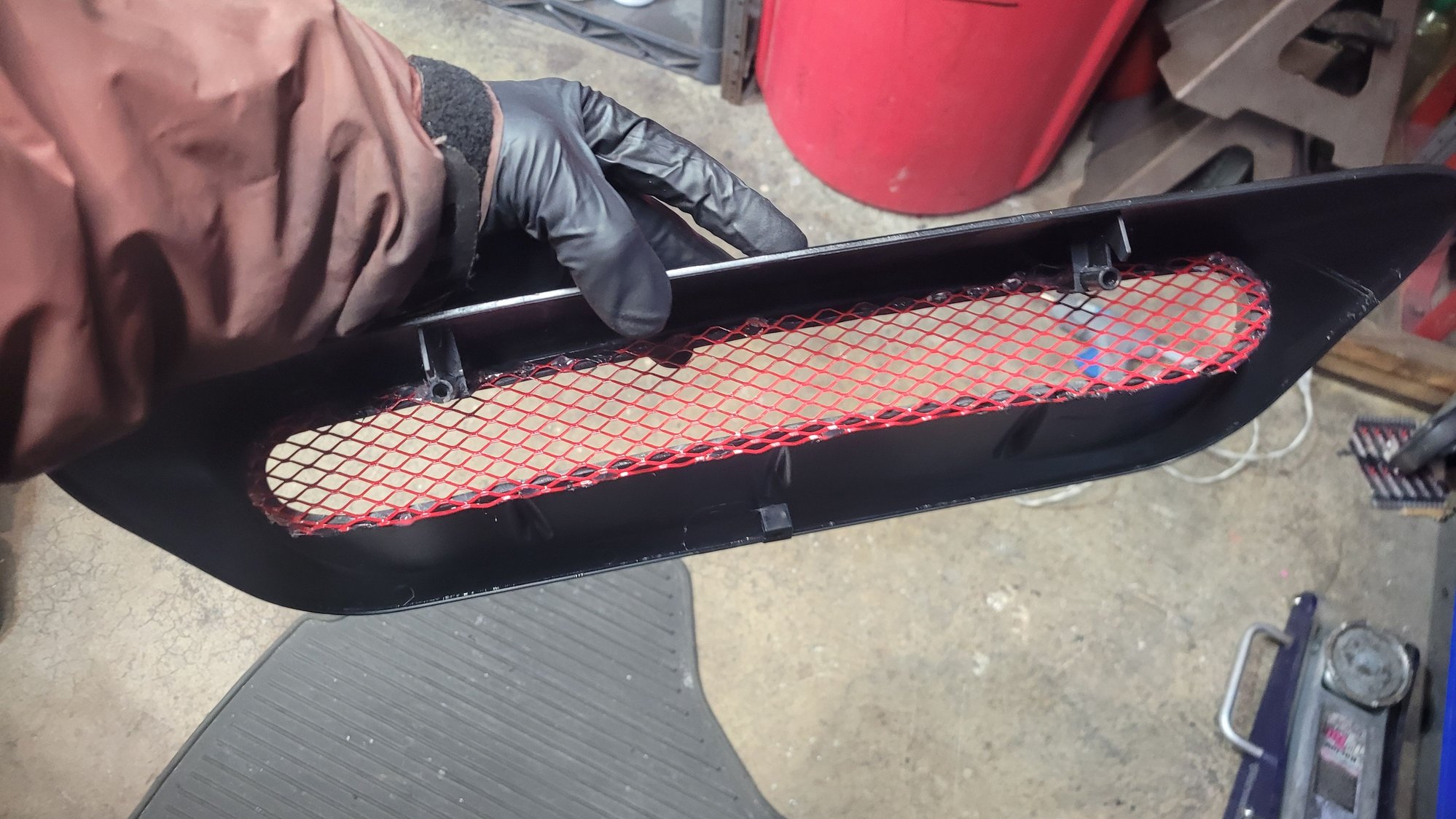

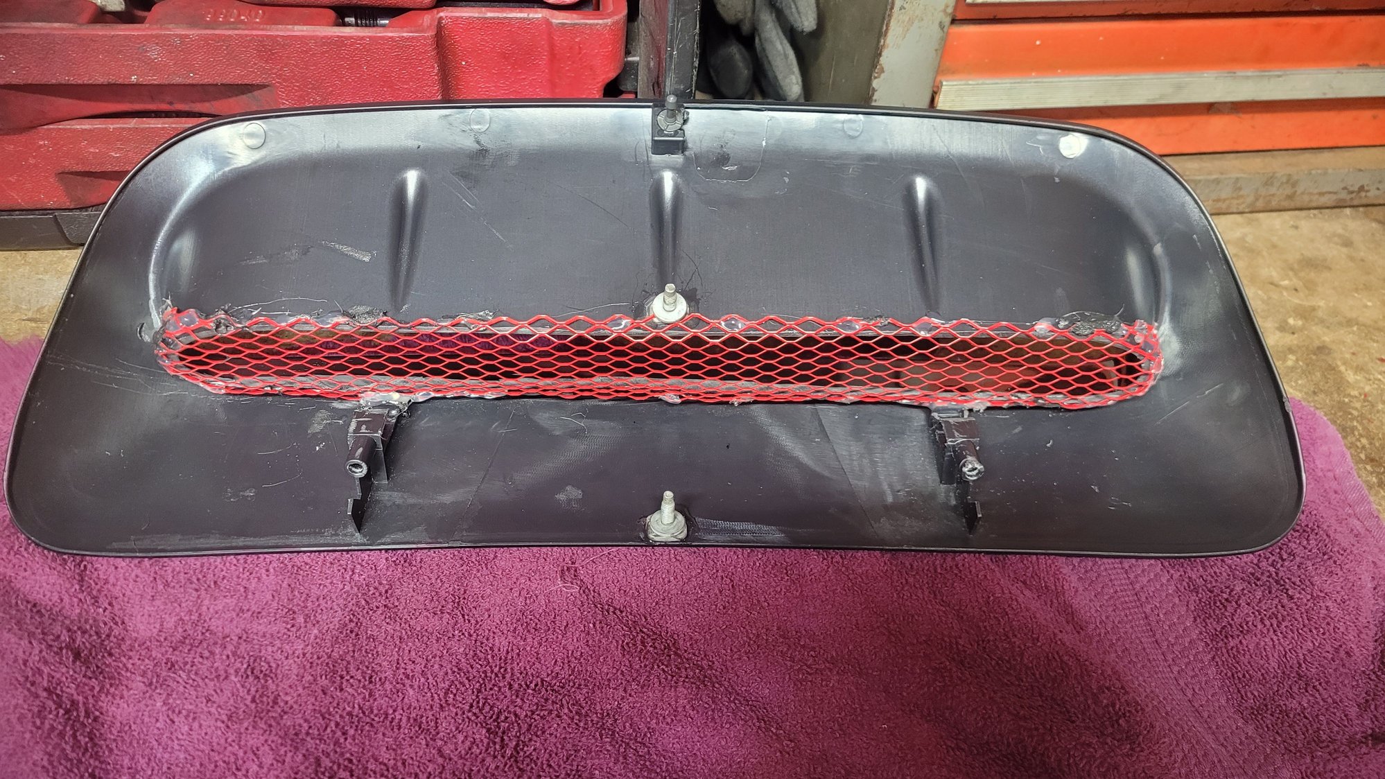

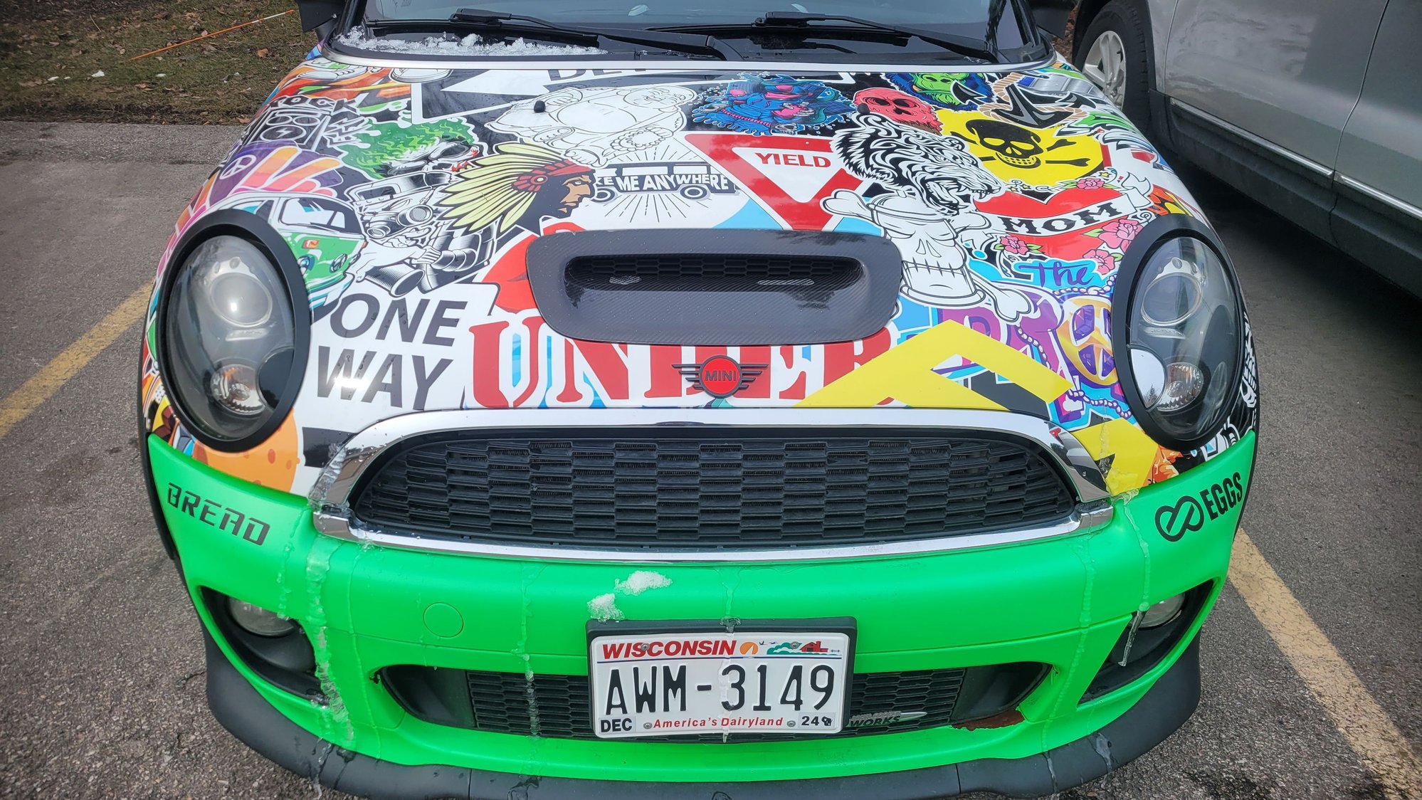

I removed the jcw cf hoodscoop and put on a more aggressive Amazon special and I also added my own grill to the scoop and opened it inlet up alot. I also cut a larger hole in the hood to better ram air into the top of my airbox when the times comes and I make the unser funnel feed into my airbox lid. I will also add an additional coldair intake on it back side for it to pull coldair from the cowl area also , like the r53s..
but here's some progress pics...

You don't necessarily want more air through the scoop.
If you are tracking the car, the big problem is heat control, water, oil and intake temps. That is especially the case if you are running a bigger intercooler that effectively reduces airflow to the radiator. Part of the key to controlling temps is maximising airflow through the radiator and intercooler. To do that you need as big a pressure drop from front to back to increase airflow. The scoop funnels air in behind the radiator, and actually increases pressure behind the radiator, therefore reducing the pressure gradient. A bigger scoop increases that problem.
In the mini challenge cars they had a fair few problems with overheating in the first generation, which was exacerbated by close racing and drafting, reducing airflows. As a result in the second generation they came out with an improved scoop, that actually was completely blanked out on the front, but had venturi vents further back to draw air OUT of the engine bay, and increase pressure gradient across the radiator and IC. That worked much, much better.
Later on, the GP2 also had an undertray with venturi vents, also to maximise airflow OUT of the engine bay, and increase pressure gradient

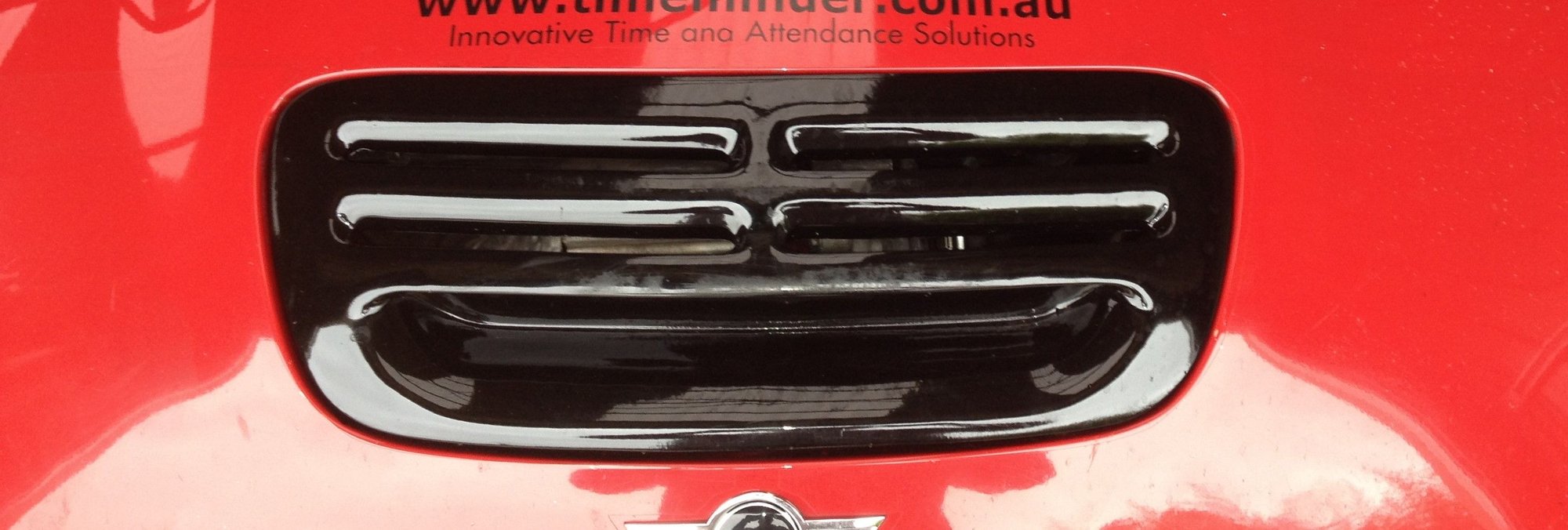

Have a look at this
https://www.trackdevelopmentsuk.com/...e-bonnet-scoop
Here is a pic of one on my old racecar

I'm my case I absolutely want more air through the scoop ! I'm going to utilize that for a ram air into my intake box and also having a funnel from the rear cowl area too then I will probably run a velocity stack with an airbox to help catch the air. I will also be making a 2nd turbo shield out of thicker aluminum and cost that too and that will bolt on above the blanket. Then to finish it I will utilize the front air intake and route that directly onto the turbo because I will be pulling cold air from better places.

Just commenting on a couple of things in this post...
Save yourself the hassle of trying to fabricate a scoop to an aftermarket filter box, and just splurge for the AEM intake. The amount of time and money you'll spend trying to rig something up, you'll probably break even if you had just bought the AEM kit. The AEM kit utilizes the OEM cool air scoop from the side of the radiator and adds the duct from the hood scoop, so it gets plenty of air. No need for a cowl duct also.
The way this engine works, the coolant temperature is controlled to the coolant temperature sensor electronically. The thermostat is electronically controlled by the ECU to the control set point. There are no "cooler" thermostats for the car. In order to change the coolant control set point, you need to get the ECU remapped.
Anything you do to route air around the radiator will create a higher pressure in the engine bay. Routing the front intake to the turbo area will do just that.
The radiator is already aluminum on the car, so again, no benefit from aftermarket there either. The OEM radiator has more than enough capacity to to keep the cooling system in control. The engine might benefit from an external oil cooler, but there is already a coolant to oil heat exchanger built into the oil filter housing.
