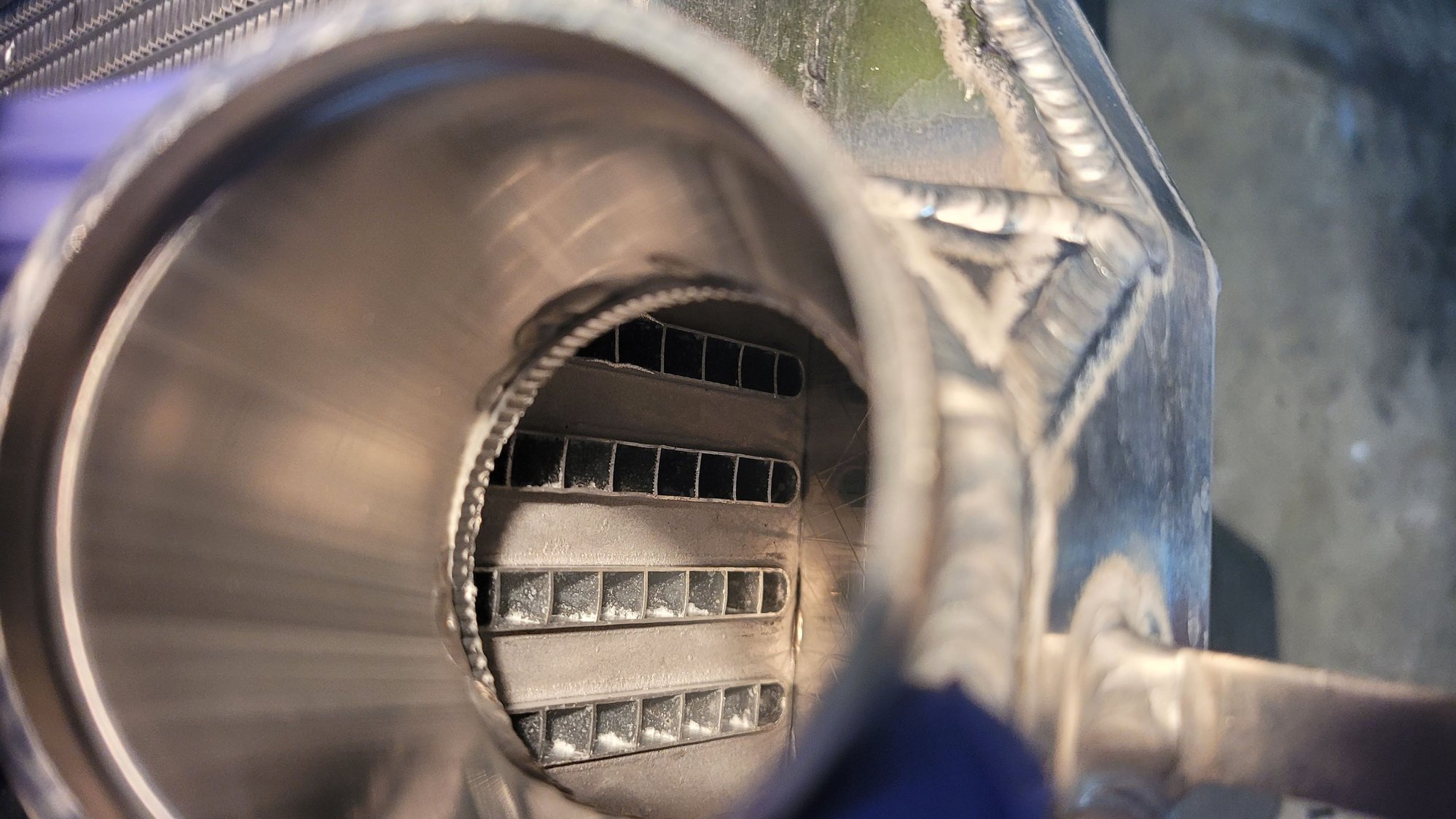

Sweeeeet , aem scoop came !! I ALSO ordered a velocity stack and some heat shielding and I plan on making my OWN custom intake setup so if your interested, check back soon because I'm gonna start the intake soon as everything is here by next weekend.
I'm also ditching my intercooler and going with abit more expensive but again ebay brand. The one I'm getting now , it's end tanks ate a different design, its core is a more dense core also and though it too is an aluminum intercooler, it weighs almost 2x of my current ebay ic SO that DEFINITELY tell-tale of it having a much more dense core..
My car has 0 boosting issue so i feel i could sacrifice abit of boost running this type intercooler and gain the extra cooling advantages..
my current ic is a FORGE clone and im now going with an airtec clone... funny thing though guys , I guarantee ALL the clones and o.g namebrand intercoolers , id be willing to bet they ALL come from the same factory in China or Malaysia , why pay the 200% markup for a silly name and sticker put on or spray painted logo on the intercooler ??? Lol I could spray airtec on it as they sell stencils and it wouldn't cost me 200$ to do it.
the 1st pic is the ic i have now ( seems to flow well , cool OOOOOOK and fitment was perfect)
2nd pic is intercooler I bought to replace it with and try.
( should loose a tad more boost , should cool much better and fitment might suck as it has NO tabs or mounting provisions , it needs them welded on)
I'm also looking into an all aluminum intake manifold too. It could give me ability to direct inject methenol into the individual ports. Plus it looks like it would FLOW.

Sweeeeet. Got a accurate boost gauge in finally and the car is perfect..
I also got my new intercooler so you can see how much more dense it's core is. I need to have 2x brackets Im making welded on ,then I can install it.
I put on the 4.5in velocity stack along with a heatshield under it. The filter literally sits PERFECTLY under the aem scoop. I bought some flat thin aluminum im going to finish making a heatshield/water diverter out of.
I aaaaaaaaaaaalso got the knock off forge bov and lol derderder the forge one i have wasnt working rite BECAUSE I MIXED up 2x vacuum lines derderder.
so now this baby builds boost EXACTLY like it should , holds it and immediately releases it with a hella loud whoosh !
WAIT until i upload a vid if how this car sounds AND pulls. I just took my bud out and he has a 2010 s that has decent mods and tuned by Adrian also. Aaaaand his car feels SLOW compared to my jcw.. only difference really is my jcw lower end , jcw catback and I have a k04 f21 and his is just a new stock k03. But there not even comparable honestly.. I'm soooooo glad I got the jcw n14 because there's much much more of a difference between an n14 s v jcw and an r53 prince S v even the jcw 220 package..
AhhhhOoooo yea. I also finished wiring up my headlights and put in brighter better led bulbs. I also sucked out the brake reservoir a few times until it was clear fluid once again ( lazy brake flush for now ) and I got the timing tool and timing stuff should be here tomorrow and then I will be dropping the car off with a buddy and he will be helping me out by doing the job for me for a price I absolutely can't complain about..

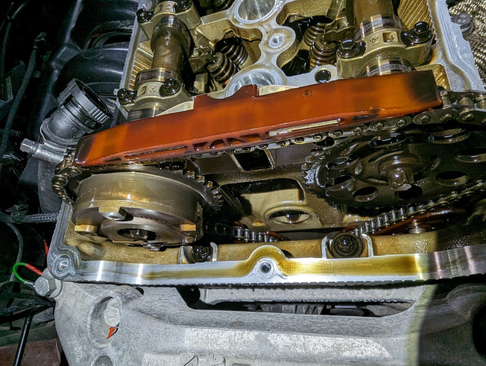

Car was dropped off and having timing done along with new vanos gear ect..
lol what a pita thx to amazon delaying the 1st set , then sending a set for n/a engine and finally got it rite the 3rd time..only after me driving the parts back n forth for like 200miles UGH. Awe well , the car is in great hands atleast.
I had the tabs welded on the ic too buuuuuut i think i had them welded on too high up.. **** it , ille rig it up still if I have to make a bracket hold a bracket ? So be it.
just frustrating with all this running around and accomplished nothing other than wasted gas and time..
Also a piece of the chain guide broke off and is in my damn oil pan so looks like I will be having to drop the pan soon as the cars back home. Again , what ever. Atleast I can take out the p.o.s k&n oil filter and put in oem. I think I'm gonna change from 0w30 to either 0w40 or 5w40 just because my r53 , once I switched to the rotella 5w40 truck oil, the engine has never sounded better. No valvetrain noise what so ever even after sitting for a week at a time. Then when i do the oilpan i will also change out the gear fluid too and 2x check the brake/clutch fluid and see if it's still clear or if I worked any dirty old fluid out from anywhere. I'm gonna need a serpentine belt too very soon..

Where's the rest of the bolts for the kit........only one I see is the tensioner.....
What he said.
You want to make sure you use all new bolts for the crank and both cams. They are use once only.

Originally Posted by njaremka
What he said.
Also new crank shaft bolt---Bolts for the chain guides

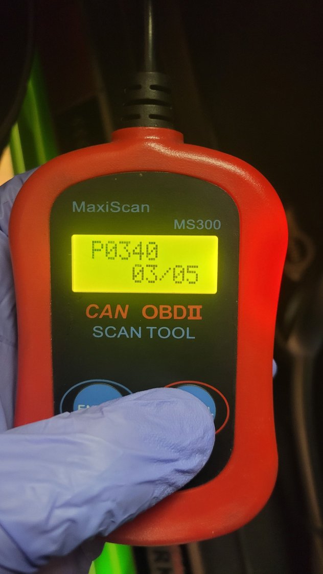

HELP !! TIMING WAS DONE , cars wayyy down on power and WONT go psst half throttle snd is throwing codes only 2x I can read are !.
did he **** up my timing ???

First, you need to invest in a Mini scan tool.
Second, did the guy use new cam bolts and crank bolts? Those are one time use bolts. Once they get torqued, if they have to come off, then NEED to be replaced. You never replied on that point.
Third, who is this guy? Has he EVER done a timing job on a N14 or N18 engine? There are some very important steps that NEED to be followed, or it will end in a botched timing job. Things like... you need to pin the crank in the correct spot, the cams need to be in the correct orientation, don't spin the crank counter-clockwise, the tension tool needs to be used instead of the tensioner... Miss any of these items, and a second timing job is in your future.
I have inpa , will that be good enough?
It's me. I've not done a timing job on an N14, but I've done a few dozen timing jobs across plenty of foreign makes/models. I'm familiar with the general requirements of the job, and found reputable resources for the specifics of this job. (Specifically FCPEuro/Pelican parts)
Prior to disassembly, the crank was pinned, and cam text was verified to be in the 'up' position on both intake and exhaust. At this position, the locking tool on the exhaust cam slipped right on, and the intake cam needed to be drawn down ~2 degrees in order to fasten to the exhaust half.
Timing hardware was removed, and once the correct timing kit was delivered, everything was set in place. Cassette dropped in. Crank hub slid through crank sprocket, and both gears were replaced with those provided in the kit, and new bolts were used, finger tight at this point. Crank bolt was installed finger tight. The kit did not come with a replacement bolt. We decided to proceed, and Adam would address it in the future. Before committing to this with a *180 TTY bolt, I checked that no necking/elongation was evident, and even at *180 past 50NM, its very close to the 'recommended' torque values of 130ftlb for a class 12.9 lubricated M14 bolt.
Guide pins were installed, upper timing chain guide was installed. At this point the manual tensioner tool was installed. I don't have a torque wrench that goes down to 0.4Nm, and did have to estimate the 3.5 inch pounds required. Exhaust cam gear was torqued to 20Nm +90* and the intake to 20Nm + 180*
The crank bolt was retorqued a few degrees shy of 180* and then the timing chain tension tool was removed and the replacement tensioner was installed. I removed the cam lock tools as well as the crank lock pin. I spun the engine over 720* clockwise, and the crank pin slid in exactly where expected. Cam text was vertical and the lock tools slid right on.
I reassembled everything and in my desire to get the car back to Adam I committed the major sin of not taking it for a test drive. I idled it in the garage, and pulled it into the driveway for him to come pick up. I made the mistake of expecting positive results based on the physical checking of timing, the clean start, and my experience/comfort performing these procedures in the past. I shouldn't have allowed Adam to take the car without an actual test drive.
I'm going to head over to Adams tonight to help him work though it. I'm very much struggling to believe it's related to physical timing. I'll pull the valve cover again and give it a triple check with the lock pin and cam lock tools.

Sounds like you did everything correct...
I just went over to https://bmwfault.codes/ to check the P0100 and P0340 codes... the 0100 looks to be related to the MAF sensor, and 0340 is a missing cam sensor signal. Hopefully its just some connectors that got missed, or not seated correctly...
