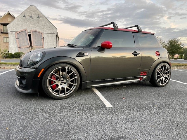

Like others have stated, you can't go wrong with Bilstein B8 struts. My JCW had the sport suspension and I honestly feel the Bilstein B8 struts with HR Drop Springs are on par if not better than OEM sport suspension. I know there is Bilstein B8 kit that comes with Eibach springs but I've never been a fan of Eibach and prefer the H&R instead.
