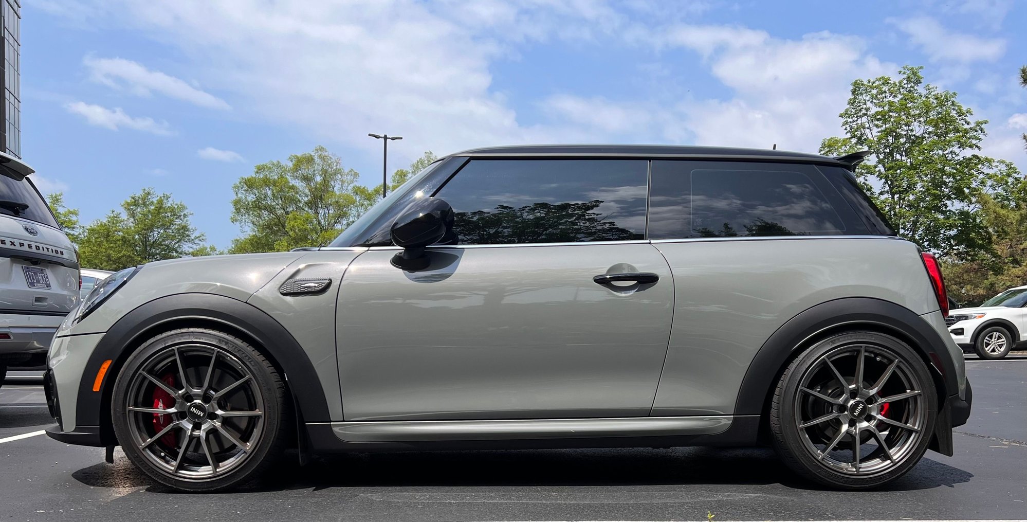

Ended up getting it done for around $1000 for the NM springs and rear swaybar. It’s incredible the difference this has made. I swear the car just dives in the direction that you turn the wheel now. I almost feel like I could get the rear end out if I wanted to. I’m probably going to chew my tires to bits. If anything the ride is better than it was before. Stiff over bumps, but in a smooth way. No banging as I had before over road joints. One issue is that the swaybar was installed upside down. Getting that fixed next week. Hopefully that will cure some creaking that I’ve had in the rear. Anyway, if you’re thinking about it, go for it!
Pic attached to show the ride height.

Looks great … Did you also get the alignment done? If so, did it come into factory specs? What wheels are those? And specs? My JCW is on order and I went with the factory 18” wheels so |’ll need some winter wheels. Sorry for all the questions

When you say the ride is better than it was before, what exactly got better?

Question, I see the rear is sitting a little lower then the front? Do you have something in the trunk? Or is that how it sits?

mostly that I’d get a bang over joints before and now I don’t. It’s stiffer. Maybe some would consider that harsher but I’ll trade a stiff feeling for the bang I had before.

No junk in the trunk. I’ll have to look closer. Could’ve been the upside down sway bar. Fixed now. Could be lighting. Could be then fronts are closer to the fender so that there is shadow in the rear. Could be that the rear is really lower.

Standard ride height for the Mini when measured to the fender is to have the rear slightly lower than the front. HOWEVER, if you measure at the side sills to the ground, the rear is slightly higher than the front. If you look very closely at the picture, you'll see the rear is raised just so slightly at the side sill.

Thanks... Maybe the front will settle some with the weight of the engine. Still looks great

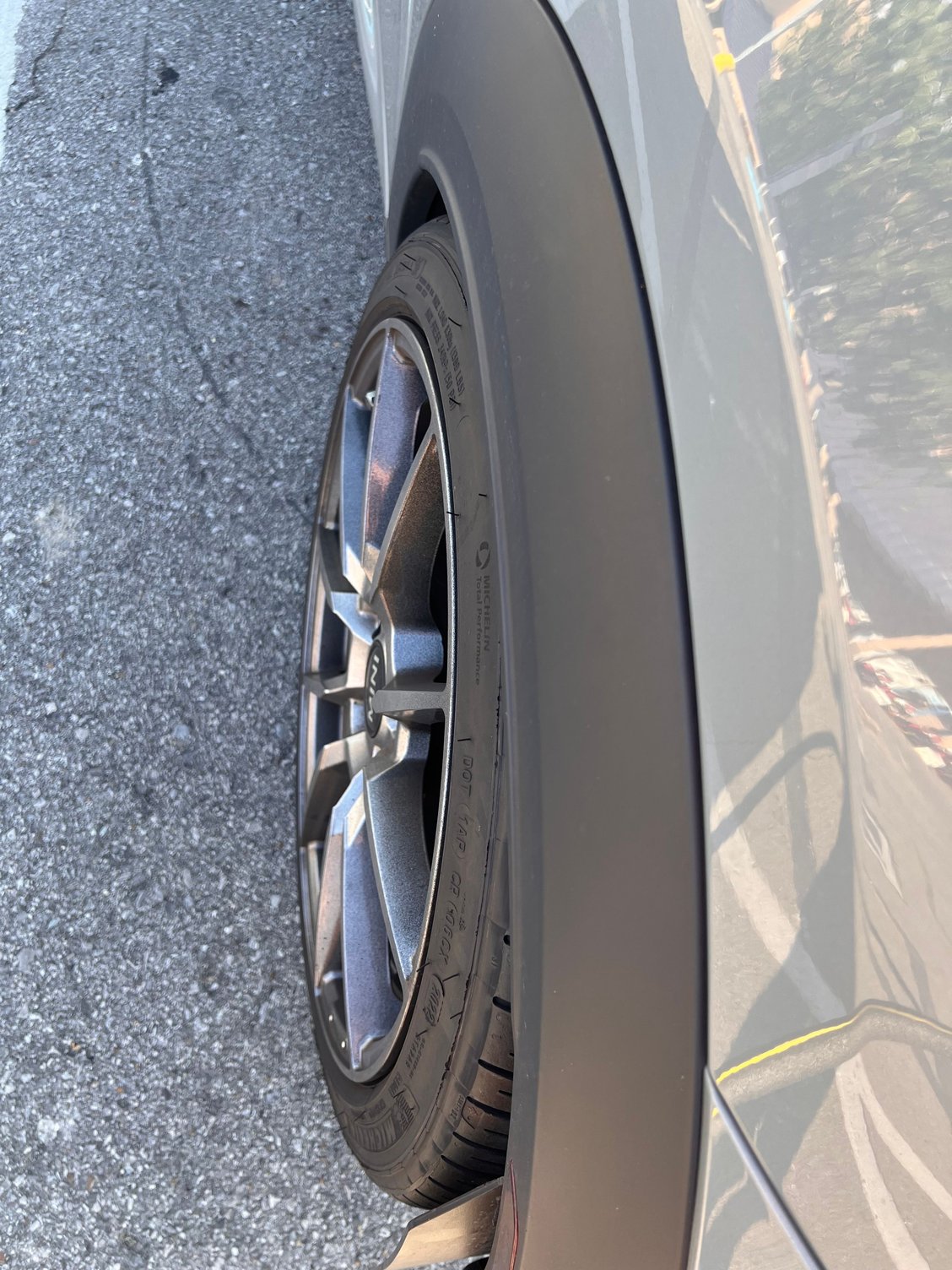

hotchicken By any chance do you have any side pictures? I want to see how the new wheels and tires sit? Thanks...

OK you mean “down the side”. I’ll snap one. I have 15 mm spacers on the rear, and I think five in the front. The rear rubs on bumps and hard corners now, so I’m going to have to put on skinnier spacers. It’s flush to a slight poke rt now. Depends on the angle.

here you go
Rear from above

Thanks... I was concern about the fronts sticking out but being your running spacers I think I'll be ok without them. I would like the fronts to stick inside the fender trim a little without any poke.
I see your running the 18X8.5 I will order the 18X8 45et which will sit in more.

BTW spacers in front are minimal. 3mm I believe. 15 in back.
