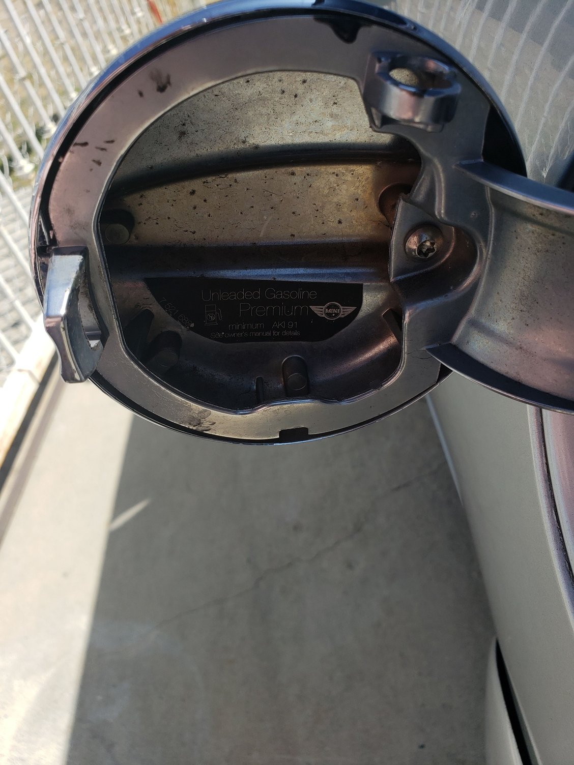

Also if not mistaken in this vitage JCW, an additional "fuel octane type required " foil decal came in the dealer installed kit too. It would be affixed under the gas cap flap area to indicate the higher octane requirement, and in addition to/near other factory decal there.

gas cap
Gas cap sticker

Yours seems authentic. I’d definitely go with the JCW belt. If you want a little more boost, you can get the ATI damper that’s 2% larger. That’s what I’m about to do. Costs about the same or maybe less than OEM. Also replace the seal that’s behind the pulley while you’re in there. It’s also a good time to replace your belt tensioner. Should let be much additional labor, if any, and it’s about $120-$160 for one from an OEM part supplier.
