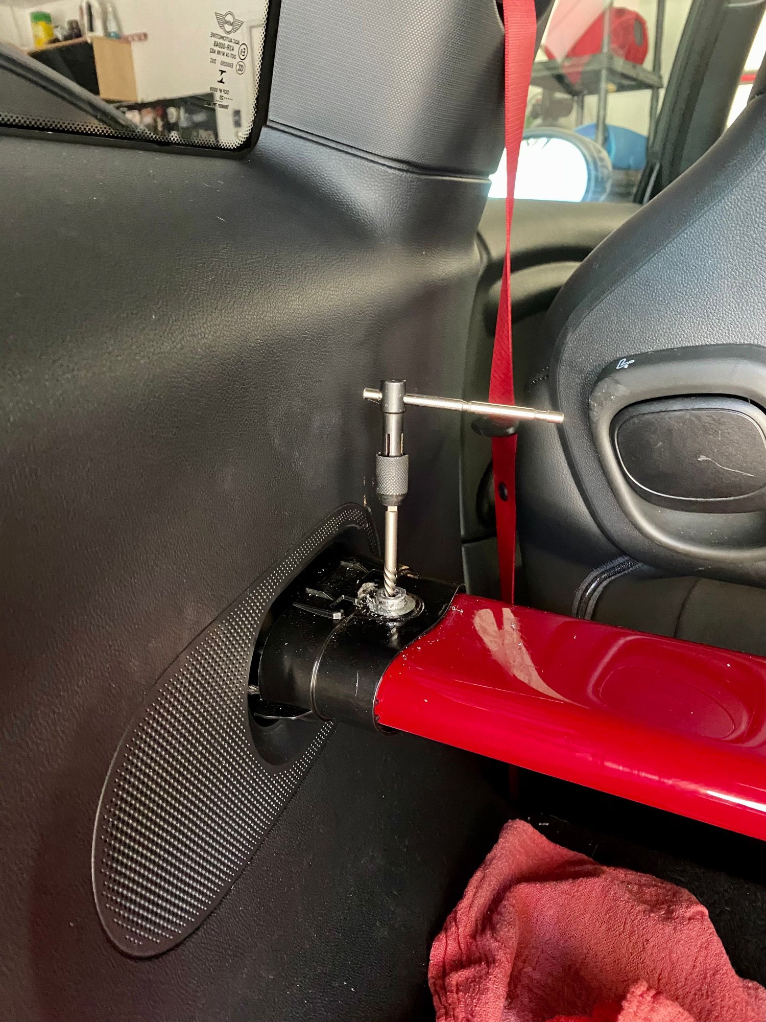

The plan *was* to remove the bar, put both plastic coverings and bolt back in (to cover that metal bracket) and be done. BUT!!!!
The driver side bolt and I had a disagreement. It wanted to stay snug in it's little hole. We fought. It was winning
Well, we have tools for this kind of thing. I was determined to win.
MOTHER BISCUITS!!!
It won. I'm defeated. Next step is to put it back together and take it in to see how much the damage will be to take get the stupid bar out.
Anyway, assuming your bolts are cemented in like my driver side bolt is, this should have been an easy process. I'll update once I get it back from the dealership and with pictures so you can see what the boot looks like without the bar.

M10 size fasteners usually use a T50 torx bit size, so your T45 may have been slightly undersized and caused your issue. Since the screw is now 'dead' for all intense purposes, you should be able to get a vice grip onto the sides of the head and get it to break loose. If not, then a trip to a local welder to put a nut on top of it is your next 'best' choice as robby71 noted above.
As for the strength of the bar, it may offer some slight side-to-side stiffening if the structure it is mounted to has any strength in that direction. That bracket it is mounted to is the limiting factor and not the screw holding it in place. Per the info noted, it is an M10 grade 8.8 screw, which has a rated shear strength of 22.3kN (~5,000 lbs), so not insignificant by any means. The design of the bracket can give you a clue as to what direction it is intended to be 'strong' in. Looking at it, it would be strong in the side-to-side direction and also toward the 'cup' side of the bracket. Since the 'cup' is toward the rear of the vehicle (from what I can tell in the pics), its main purpose was to hold the bar in place during assembly with the insertion of the bar coming from the front of the car...likely indicating ease of assembly rather than strength.

There are only 3 pieces to remove, not including the actual bar. In order, the outer plastic cover, then the bolt, then the inner sleeve. I didn't have to remove anything to remove the outer plastic cover, if that's what you're asking. Just a good yank, really.
