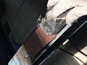

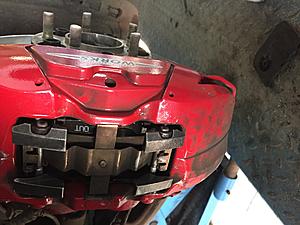

Finally, there is 100$ option for the brake pads - Ferodo FCP 4872
Or ANY oem bmw or aftermarket pads for f30 with M performance brakes, but in that case you have to grind down 3mm of extra thickness to make them fit.( oem jcw pads are 15mm thick and bmw pads are 18mm) Pretty easy though (see the picture below) I'm using them for 1000 km. already and very happy. Enjoy!
