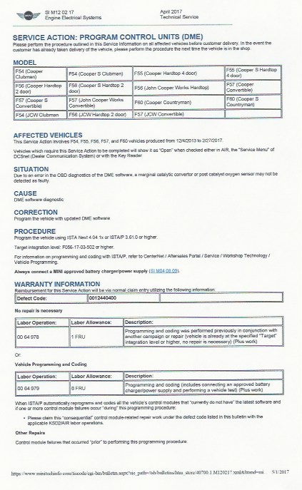

Old Sep 2, 2017 | 12:02 PM
  #443
vetsvette's Avatar
vetsvette
Moderator
Joined: Oct 2013
Posts: 3,896
Likes: 453
From: South Central Virginia
Originally Posted by TVPostSound
But they insisted on a mandatory DME software upgrade. Stated it was a recall.
But I don't see it on the MINI recall database.
Getting Mini to call something a "recall" is like pulling teeth. They prefer call it a TSB or "service enhancement". There is a copy of this particular TSB on the forum, but I can't put my finger on it at the moment. I printed it out to give my dealer the last time I went in for service, but they already had it flagged for the work.
Old Sep 2, 2017 | 12:13 PM
  #444
TVPostSound's Avatar
TVPostSound
Joined: Mar 2014
Posts: 2,716
Likes: 539
From: Granada Hills, CA
A TSB is a diagnostic aid. For a particular issue that is common across a line of vehicles.
The repair suggested can be used, but if other methods work, then they are used.
A TSB does not have to be performed at the consumers request.
I have had a few published in the past for Volvo, when I was a tech.
A Recall is a federally mandated safety repair, and is not optional.
I was told this was a "Recall".
Old Sep 2, 2017 | 12:26 PM
  #445
vetsvette's Avatar
vetsvette
Moderator
Joined: Oct 2013
Posts: 3,896
Likes: 453
I think this is it.
Old Sep 2, 2017 | 01:08 PM
  #446
trentiles's Avatar
trentiles
Joined: Apr 2014
Posts: 377
Likes: 41
From: Buffalo, NY
Yep that's the TSB that lots of car's are having done recently. I had it done to my 2016 S about a month ago. No problems with my JB4 since they updated the DME.
Old Sep 2, 2017 | 01:48 PM
  #447
TVPostSound
Joined: Mar 2014
Posts: 2,716
Likes: 539
NOT TSB.
A TSB is like the lower control arm popping. Its a common issue that someone found a remedy. It will be performed IF car owner complains of noise. Will not be done past warranty unless car owner pays for it.
You can not go in and demand it to be done.
SERVICE ACTION: Voluntary Internal Recall. MINI will to this to every car that comes in.
Old Sep 2, 2017 | 01:59 PM
  #448
Minnie.the.Moocher's Avatar
Minnie.the.Moocher
Joined: Jun 2014
Posts: 5,391
Likes: 576
From: earth PNW
Recall, Service Action, TSB
All that really is of concern in this thread - does the DINAN work correctly after the "procedure", especially in Sport+ or Race Mode. Anyone know the answer at this point?
