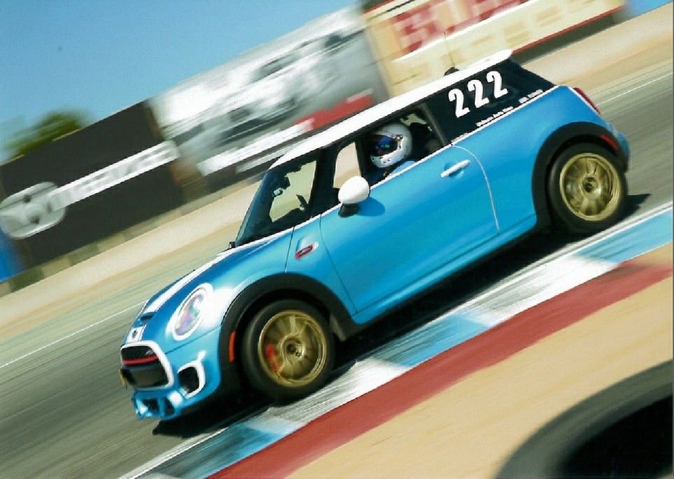

I WHile it is not the exact same size, I have the Team Dynamics Pro Race 1.2, with the 17x7.5 +45 wheels, with 215/45 R17 Pilot Supersports, with Eibach Springs, and there are zero fitment issues. I would wager that an extra .5 inches of wheel would be fine, looking at my inner and outer fenders.
Reply 1
Feb 11, 2018 | 12:36 PM
  #99
Quote: I WHile it is not the exact same size, I have the Team Dynamics Pro Race 1.2, with the 17x7.5 +45 wheels, with 215/45 R17 Pilot Supersports, with Eibach Springs, and there are zero fitment issues. I would wager that an extra .5 inches of wheel would be fine, looking at my inner and outer fenders.
Cool wheels!) Please provide more photos!)
I am currently choosing between 17 and 18 inch and can't decide which one is better)
Reply 0
Feb 11, 2018 | 12:47 PM
  #100
I went with 17's primarily for weight reduction, and that I could fit a bit meatier tires on them. These are about 7 pounds or so lighter than stock, and the tires are a few pounds lighter too. They are great on the track.
Laguna Seca
