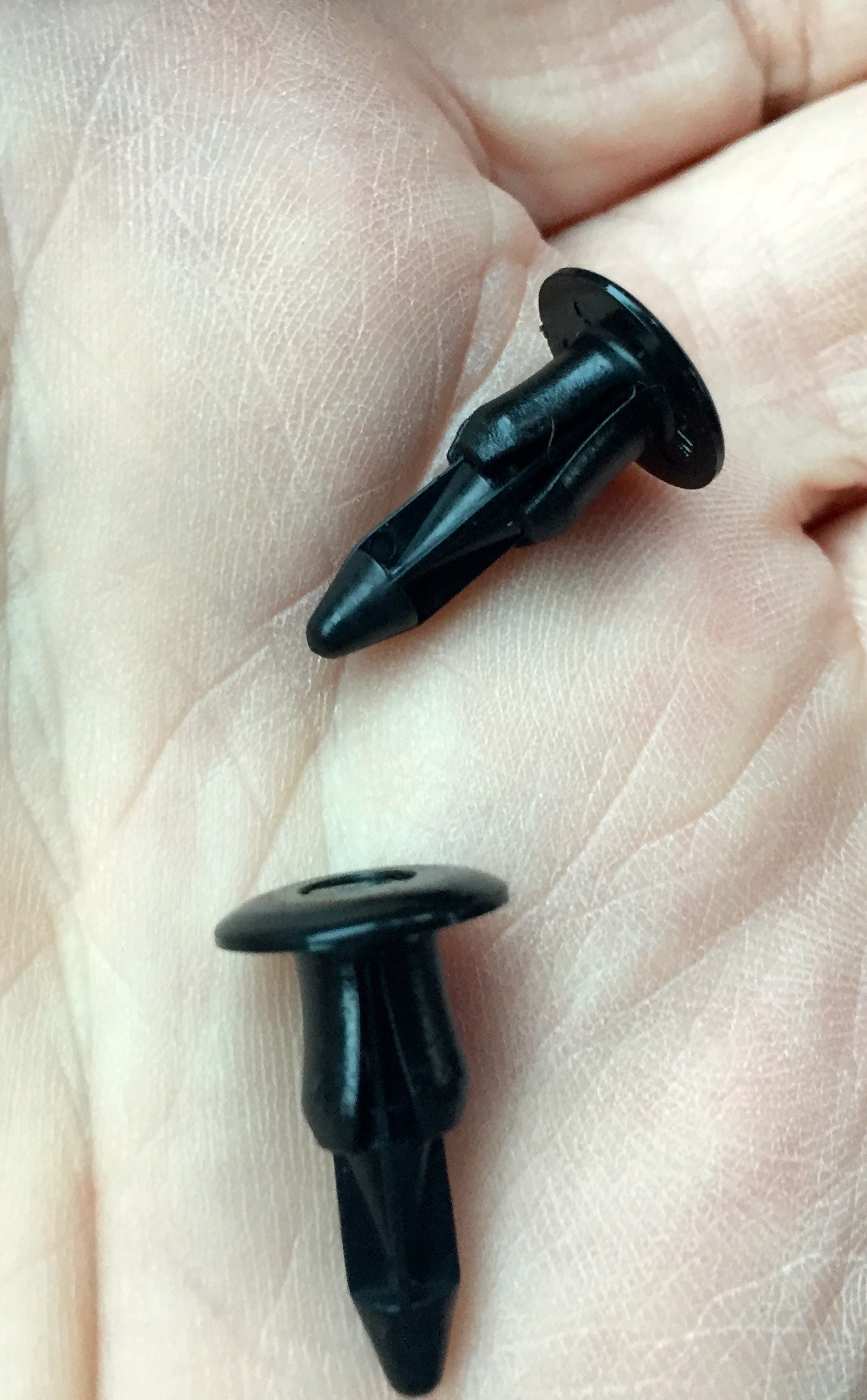

Pulled mine off today. Attached are pictures of the pins (there are two on mine) and the tool I used to remove them.
When you re-install the pins you have to pull out on the pointy end to collapse the collet on the top part. It doesn’t come apart, but just pulls out until the pin will fit back in the hole. It won’t fit if you don’t. Once you get the pins out it’s just a matter of finessing the ring off. There are several spots that snap into place so you just have to fiddle with it a little. I took the pins out without even looking at them. Couldn’t bend over far enough because of my arm so I just located the pins by feel, started them with my thumbnail and slipped the tool under it and they popped right out. Now I have to find the one I dropped in the floorboard while trying to re-install it before I figured out the pull the pointy end out trick.
The tool I used is the one on the left. I think the set was about $11-12 at AutoZone.

Okay, so I've been looking at the plugs holding the ring in place and think I may have figured out the removal and re-install procedure. (I will verify with MINI to make sure when mine arrives). So here goes:
Looking at the two photos and plug's design and operation, it looks like the flange/collar that holds the plug in place is collapsed by pushing the center pin upward or downward. One way for assembly, the other for disassembly.
When removing the plug, to access the center stack, the mechanic would put pressure on the center of the plug forcing the bulge that expands the flange past the edge of the flange causing it to collapse and allowing the plug to be removed without forcing it.
Looking at the center pin, it appears to be designed to release the flange by either inward or outward travel.
During re-assembly, the mechanic, resets the plug
(creating a two tiered look) the pin can be re-inserted and the by pushing the center portion in after plug is replaced, will expand the flange holding the plug in place?
Just thinking on the design of the pin. It would make sense to be able to release the flange either by pushing the center pin beyond flush to release it and flush to lock it back into place during re-assembly.
Just a guess, but seems to make sense to me.
More later
Just tried it myself with a wooden dowel and pushing the center in, the pin virtually falls out for removal, for re-install, reset the pin so the inner pin is above the plug edge, insert plug nd push the pin flush.
Attached Thumbnails Blind Ring Change-20150717_132318.jpg   Blind Ring Change-img_1337.1.jpg

You are correct Dennis. I tried your method using a ballpoint pen to push the center pin in and was then able to remove the pin with my thumbnail. Push the center out until it protrudes from the top of the pin and re-insert it in the mounting hole. After it's inserted just push the center in and you'll hear and feel a pop as it goes into place. My way worked, but took un-needed force to do so. That's what I get for overthinking something that in actuality is very simple. You still have a little bit of a fight on your hands to get the ring itself to pop loose from the dash...... unless someone else come up with a revelation on that.

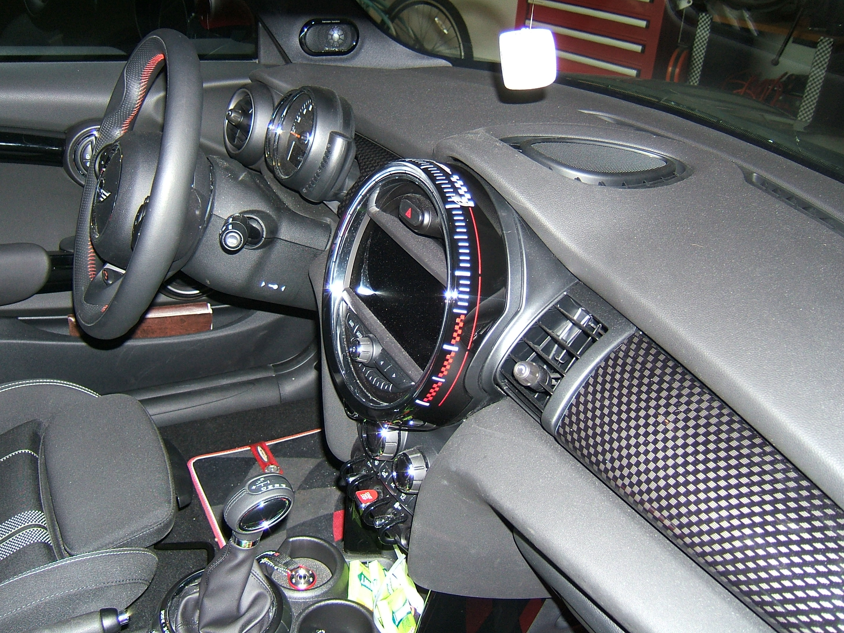

Mine arrived today and installed in about 3 minutes. Hardest part was getting the old ring to snap off the dash. Working from the bottom and pressuring upward helps release the top clips. Still kind of a "snap" when the ring releases, but no harm, no foul.
New JCW ring installed without a problem, snapped into place and the two holding pins were replaced.
Looks great in the car IMO. With the JCW mats, rear view mirror cover, and other appointments, the ring just finishes the interior off perfectly.
That center stack seems to be the focal point when sitting in the car, so that ring is very noticeable (in a good way for me at least and wife likes it too) if you like the JCW look.
