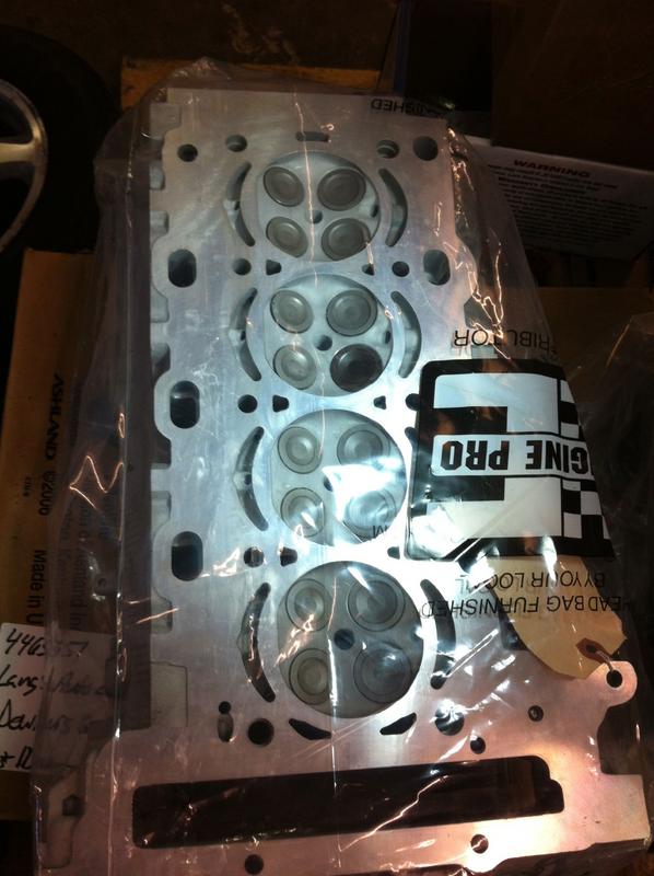

It's not dead. Just got the OS clutch today. See the attached pictures of the throw-out bearing. This OS clutch makes the stock clutch look like a tin can.
So today I bolted the clutch on. Trans is bolted to the engine. Installed the turbo and oil lines. Attached the starter and verified we have oil pressure. Wife bought the Methanol and distilled water. Friday we will do the install. And hopefully have it running.
Attached Thumbnails 9000rpm engine rebuild has started!!-img_3664.jpg   9000rpm engine rebuild has started!!-img_3665.jpg
Old Nov 23, 2011 | 06:25 PM

More pictures of interest.
Attached Thumbnails 9000rpm engine rebuild has started!!-img_3392.jpg   9000rpm engine rebuild has started!!-img_3396.jpg   9000rpm engine rebuild has started!!-rod.jpg

A few more.
Attached Thumbnails 9000rpm engine rebuild has started!!-img_3555.jpg   9000rpm engine rebuild has started!!-img_3593.jpg   9000rpm engine rebuild has started!!-piston.jpg

What C/R are theese?
Old Nov 23, 2011 | 07:05 PM
  #67
mrrjm's Avatar
mrrjm
Joined: Nov 2010
Posts: 161
From: IL
I'm told they are 10.1:1, Also we took .003" off the head. JCW stock is 10:1. So we have a slight bump in compression.

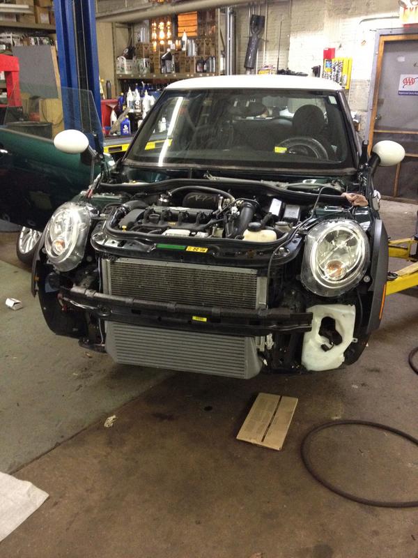

After 12 hours yesterday we got it running and the Auqamist installed!! It not drivable yet. Still have things to finish up. The eng sounds really good. No noise at all from the forged pistons. The OS clutch doesn't feel heavy at all. We also installed the water/meth injector at the outlet of the intercooler.
Attached Thumbnails 9000rpm engine rebuild has started!!-img_3693.jpg   9000rpm engine rebuild has started!!-img_3692.jpg   9000rpm engine rebuild has started!!-img_3691.jpg

Yes it is. Put about 100 miles on it so far. Been trying to keep it under 10 psi. Though I've hit 15 twice. Runs great except for some cold driveability issues. I think because of 6 month old summer gas. I should have the tank empty in the next 2 days. I the Aquamist is in and set to kick in around 15 psi or so. It only activated a couple times briefly. I don't want to get on the throttle too hard until the engine is broken in a bit.
As this thread started my goal was "9000 rpm" That ain't happening right now due to valvetrain limitations. Supertech is working on springs and retainers. Also I'm using my Alta turbo not the GT28. I'm not going to do anything with the GT28 until at least Spring 2012.
I learned a lot about the car and engine during this rebuild. If anyone needs help or has questions ask away. I'll help however I can.
