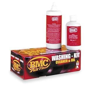

BTW, I didn't discover this until later. How about using BMC's own filter cleaning kit instead of buying expensive new filters from MINI.
http://www.amazon.com/BMC-Air-Filter...=315MC678LWK3S
only $13
only $13
I have not been replacing the filters. I have been cleaning, and oiling. I have not gotten the BMC wash/oil kit, but have been using the K&N wash/oil kit. Don't know if it is any different. Maybe someone can answer if it makes a difference to use the BMC or K&N wash/oil kit.
