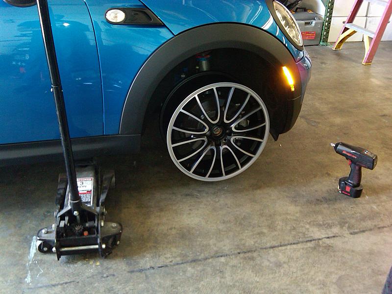

I bought them they looked great, I took them to get powdercoated and I'm just waiting on tires to arrive

For imposters, they sure look real. I'm sure someone will chime in but I thought the stock offset is 38.
If the stock offset is 38 and those are 40, that would kick the wheels outward. I've got 18's on mine and wish I could have moved them in, not out. (I'm running 225's)
Mark
My factory R104s have an offset of 48. My OZ wheels have an offest of 37. The OZ wheels are kicked out by 11mm. The lower the number the furter out the wheel. With the OZs mounted, when I have passengers riding in the back I will, on occasion, get a bit of tire rub going over big bumps.
Old May 23, 2010 | 05:14 AM
orangecrush's Avatar
orangecrush
iTrader: (37)
Posts: 4,782
From: Charlotte, NC.
Thanks Scott, I said it backwards.... I always do that.
I did the same on my OZ's. I flared the sheetmetal a bit but it scrubs with a passenger in the back (on the pass. side) but it's only the fender liner, not the metal.
I actually took the fender liner out and trimmed about an inch of it. The fender liner is more for sound deadening than it is about keeping water out of the body. The inch I took out doesn't really make a diff but it doesn't allow the liner to get beat up.
Aztec,
Very impressive. I like the look, great deal, great price. Make sure you post some pics when you get the tires mounted.

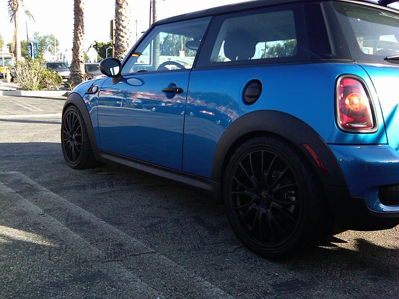

wheels are on
here are some pics of the finished product

Absolutely love it... the car looks great. Have you thought about painting your headlight trim rings and grill surrounds laser blue?
Your car looks GREAT!

all u need now is the JCW centre cap
Old May 26, 2010 | 09:06 AM
aztec1382's Avatar
aztec1382
Joined: Feb 2010
Posts: 111
i kinda like the blackeye look
and im not really into the jcw centrecap
but i do need a jcw aero kit
