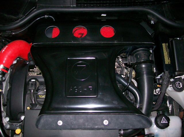

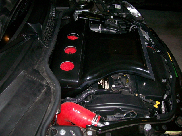

Installed the CAI this last weekend. I thought I would post a few pics. Still waiting on the paint to show up so I can finish it on up.

I see you're going for max sound with the knock-outs too. Did you go for the aerogel turbo shield I see below the inlet there, or is that a non-aerogel shield? ( I recently read-up about the material; amazing stuff!)
Yep I sprung for the aerogel insert for the shield. I figured if I was spending that much on a intake it would be a shame for it to melt. It's amazing how much heat that turbo puts off.

Ive had mine on for over 2000 miles now and nothing not one cel. Combined with ED turbo back with downpipe, Forge intercooler, ED hard pipes and UniChip.
Herman da German FYI pluging the first hole closest to the MAF will yield the best performance.

Wondering, why not all three closed? I'd figure at low speeds there's hot air coming in from the engine compartment, or @ higher speed the pressured ram effect being lost escaping into the engine compartment.

Has something to do with velocity stack and the amount of scavanging of air around the filter. The best Dyno plot was with that one hole plugged and the other two open.

Originally Posted by mitemini
Has something to do with velocity stack and the amount of scavanging of air around the filter. Dyno plots showed a difference with that one hole plugged and the other two open.
