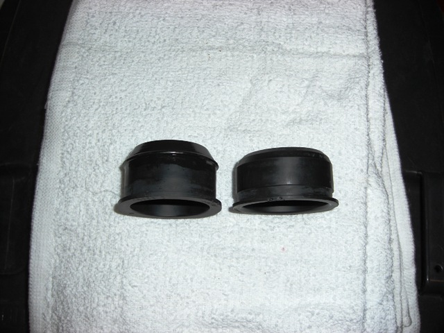

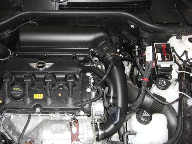

Soooooo... I picked up my new Inlet tube today from the dealer. 77 Euros, so like 115 US Dollars, not bad.
Installation is easy as heck, just 2 hose clamps and a clip on the breather hose. All you need is a flat head screw driver and it shouldnt take more than 10 minutes. Just remember to swap the rubber spacer from your stock tube to the JCW tube so it makes a tight fit with the turbo.
It drives great, doesnt bog on occasion @ high RPM's like it used to, so overall im happy. Heres some pictures of the install...

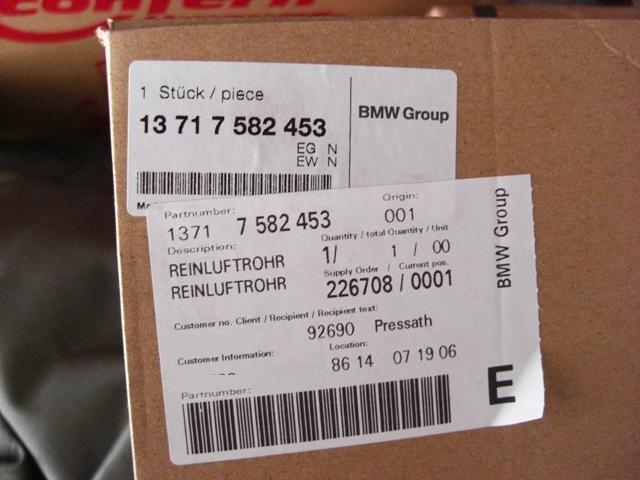

Nice.. I think euro-spec is the closest to my Middle East spec.. would you happen to have the part #? I used the part number from another thread but my dealer says it wasn't showing on the system.

My car is actually U.S. Spec, I used the part number from the other thread. It's M13.71.7.582.453
I went through BMW Pressath here in Beyern Germany

Called my dealer AGAIN and gave them the part #.. no use.. they say its not on the system.. actually they put it more eloquently and said "your number is wrong!"

So they said it's wrong? lol... show them this...

Thanks! I'm sending them the picture tomorrow.. bunch of useless....
