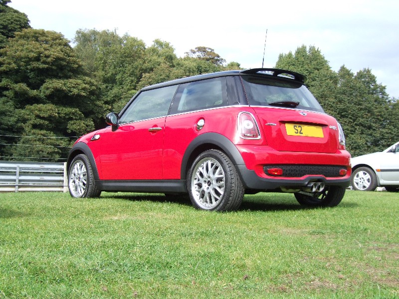

Originally Posted by fjork_duf
I'd be interested to see some pics if you have the stock Cooper S body kit. Just to see how the rear exhaust and badges look.
Werd. +1
Old Oct 4, 2007 | 02:45 PM
scone's Avatar
scone
Joined: Jun 2007
Originally Posted by rattmobbins
Werd. +1
Hope this helps. Marksmiths review sums up the kit really well and as for fuel consumption i'm back up to where I was before the kit was fitted, 32 mpg.
Attached Thumbnails JCW Tuning Kit Post-install Review...-copy-of-2006_0210oulton0045.jpg   JCW Tuning Kit Post-install Review...-copy-of-2006_0210oulton0046.jpg
